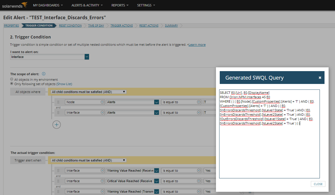

Working on an alert for interface discards. This is the swql generated by the alert:
SELECT E0.[Uri], E0.[DisplayName]
FROM Orion.NPM.Interfaces AS E0
WHERE ( ( ( E0.[Node].[CustomProperties].[Alerts] = 'T' ) AND ( E0.[CustomProperties].[Alerts] = 'T' ) ) AND ( ( E0.[InErrorsDiscardsThreshold].[IsLevel1State] = 'True' ) AND ( E0.[InErrorsDiscardsThreshold].[IsLevel2State] = 'True' ) AND ( E0.[OutErrorsDiscardsThreshold].[IsLevel1State] = 'True' ) AND ( E0.[InErrorsDiscardsThreshold].[IsLevel2State] = 'True' ) ) )

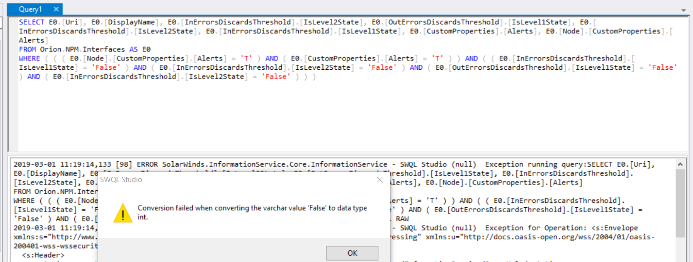

When I paste that into the SWQL studio I get the error "Conversaion failed when converting the varchar value 'false' to data type int"

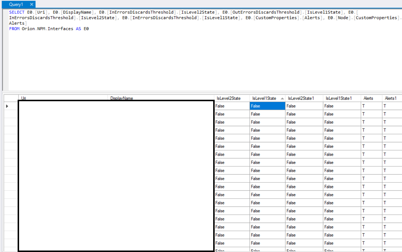

If I take away the Where statement the query returns and the values show up as False
