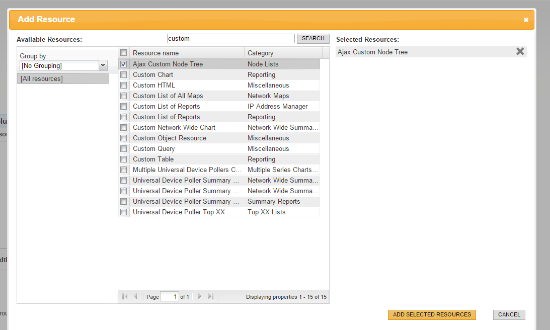

You will need to extract the 7 files listed above, contained in the attached "CustomNodeTree.rar" file, to the proper file/folder locations, also listed above.

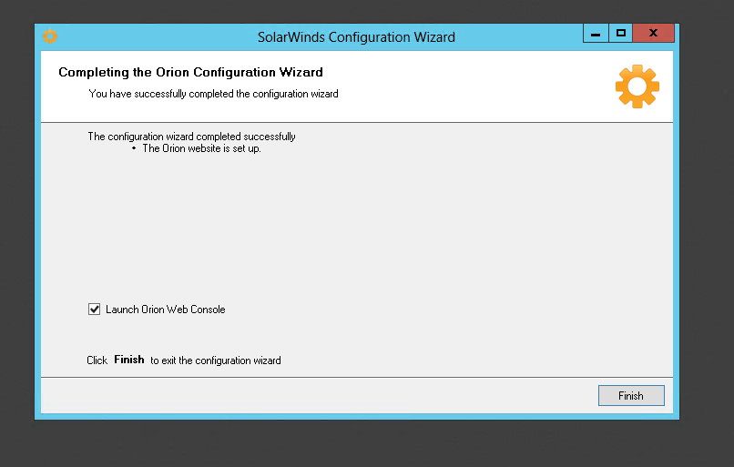

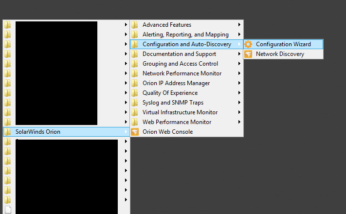

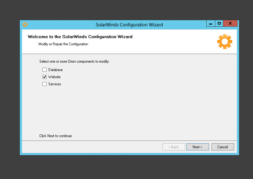

After extracting the files to the correct locations, you will need to run the config wizard. You only need to choose "Website" when running the config wizard.

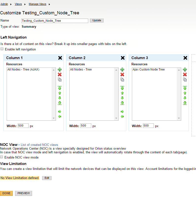

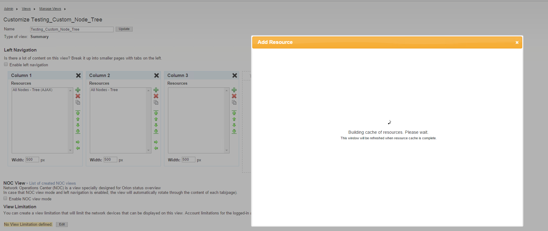

After the config wizard has completed,
you should be able to add the new "Ajax Custom Node Tree" resource to your summary page. (Being the first time to add a resource after running the config wizard, there will be a brief delay to cache some resource data)

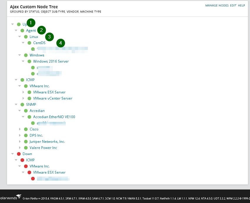

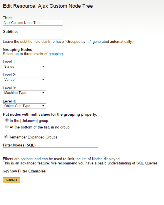

Now that the new resource has been added,
you will need to edit the resource, by clicking the "Edit" button in the upper right-hand corner of the resource.
Once on the edit resource page, you should now be able to choose a 4th level to group your nodes with.

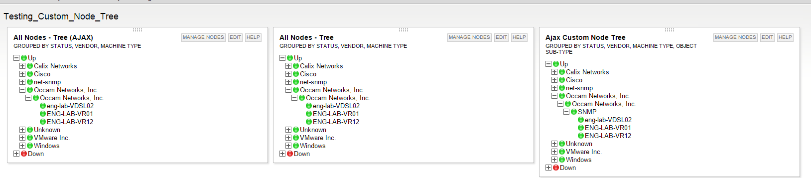

After you have chosen your 4 grouping levels, click the "Submit" button to save them and return to the results.
You should now see your "Ajax Custom Node Tree" resource using 4 grouping levels, instead of the default 3 levels.
