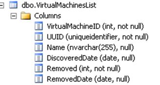

Created a new table in Solarwinds NPM DB --- called “VirtualMachinesList”, the columns are:

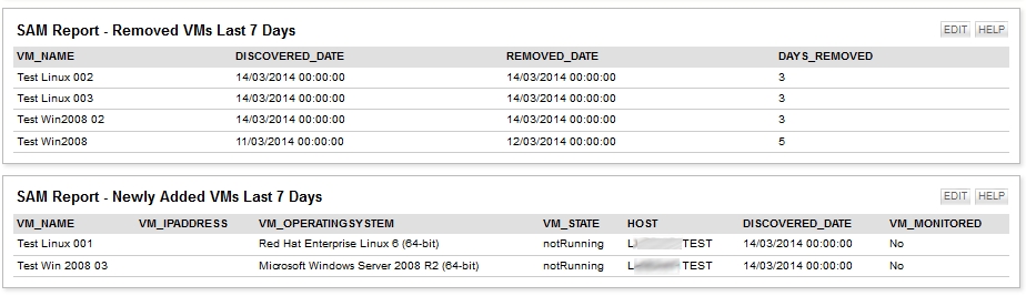

Now on Solarwinds server, run Report Write to create a couple advanced SQL reports:
Report - Removed VMs Last 7 Days
SELECT [Name], [DiscoveredDate], [RemovedDate] ,DATEDIFF(dd,[RemovedDate], GetDate())
FROM [NetPerfMon].[dbo].[VirtualMachinesList]
WHERE [Removed] = 1 AND DATEDIFF(dd,[RemovedDate], GetDate()) < 8
ORDER BY [Name]
Report – Newly Added VMs Last 7 Days
SELECT Tb01.[UUID], Tb01.[Name], Tb02.[IPAddress], Tb02.[OperatingSystem],
Tb02.[GuestState], Nodes.Caption, Nodes.NodeID, Tb01.[DiscoveredDate],
(CASE WHEN Tb02.NodeID > 0 THEN 'Yes' ELSE 'No' END) AS Monitored
FROM [NetPerfMon].[dbo].[VirtualMachinesList] AS Tb01
LEFT JOIN [NetPerfMon].[dbo].[VirtualMachines] AS Tb02 ON Tb01.[UUID] = Tb02.[UUID]
LEFT JOIN Nodes ON Tb02.HostNodeID = Nodes.NodeID
WHERE (Tb01.[Removed]) = 0 AND (DATEDIFF(dd,Tb01.[DiscoveredDate], GetDate()) < 8)
ORDER BY Tb01.[DiscoveredDate] DESC, Nodes.Caption ASC, Tb01.[Name] ASC
