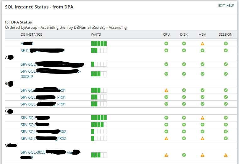

On the DPA start page we have this nice overview table of how all instances are. Wouldn't it be nice to have that in an Orion view as well!
The number of widgets in Orion for DPA information is a bit limited. So is also the information in Orion database about DPA status. Almost all info for this exist though. So we created a custom table showing the "DPA Overview" in Orion

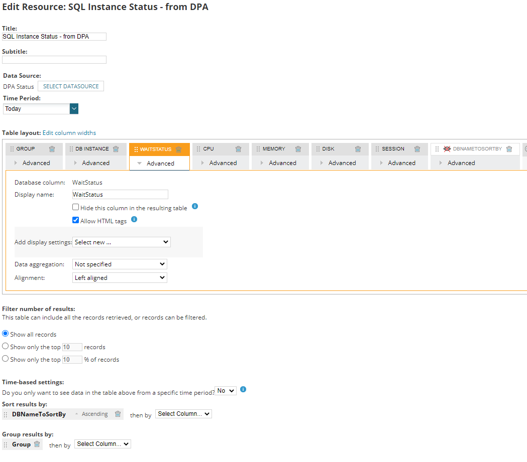

This is how you create it:
- Add a new "Custom Table" widget.
- Add a "Advanced SWQL datasource" with below code

- Add all the columns in the datasource
- On column "DB Instance" and "WaitStats" - check "alllow HTML tags"

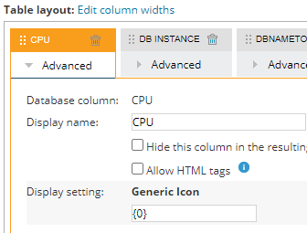

- On column "Disk", "Memory" and "Session" - Add display setting "General Icon" and change setting to "{0}"
- On column "DBNameToSortBy" - check "Hide this column...."
- Group the result by "Group" and sort by "DBNameToSortBy"
- Arrange the column as you like
- Set at Title
- You probably want to do a "Preview" and set "custom column width"
The result will be something like below
