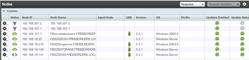

The background, we have installed a new vm server - "log & event management", I use the fixed manager - swi-lem login "log & event management" console, our old Trigeo 5.0 server uses trigeo-companyname as manager (the old name displays and error in success agent installation log below).
Issue: The Nodes picture below describes all nodes connected to the “Log & Event Manager”, I found whatever approaches I use, no any previous version agents (or node IP/name) displays here.
I tried to uninstall previous agent with previous (5.0) remote uninstall management – Failed, as no previous agent was found by the remote uninstall management tool.
Tired to install the last agent followed with guideline on page 10 of user guide. – Success with following log below. But node doesn’t display in “Log & Event Manager”.
Same for uninstall and reinstall the new version agent on old agent existed servers.
By the way, I can’t remove 192.168.201.2 and 192.168.167.1, their logs bothering me a lot, they will appear again after deleted from the nodes list, they are not the IPs we mean to monitor, I'm not sure where they come from, they appears right after the console installation completed.
