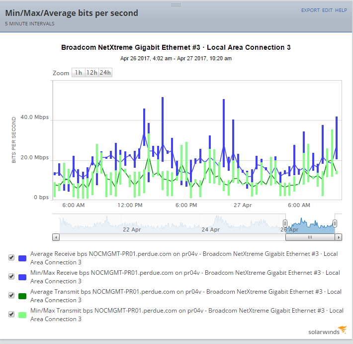

I have recently begun a trial of Solarwinds Network Performance Monitor and NetFlow Traffic Analyzer for my organization. I've been using the software for a couple days but haven't found an exact answer for our specific needs. I did perform a brief search of these forums as well but didn't find a closely matching answer.
The problem:
We have a fleet of telepresence workstations, servers and endpoints. The workstations and servers are all on the same LAN connected via layer 2 switches (no VLANs). Some of the endpoints are on different networks accessible via routers, some of the endpoints are on the same LAN as the workstations and servers. There have been times when the quality of service between the workstations and endpoints have been severely degraded. We believe that bandwidth usage between the servers/workstations/endpoints may be a problem. We need a way to monitor the traffic volume between the endpoints, the workstations and associated servers. Since we do not have VLANs, Layer 3 switches, or routers between most of the equipment NetFlow output probably won't help us much to gain end to end traffic analysis.
The question:
Will Orion Agents installed on the servers and workstations give us visibility into bandwidth utilization? Also things like average packet transmission/reception/etc... times? If so, is there a guide that would walk us through setting this type of agent up? One thing to keep in mind is that an agent would not be able to be installed on the telepresence endpoints.
