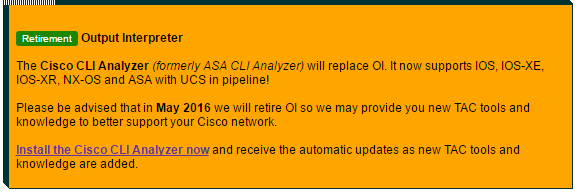

So, I was both a bit excited, plus had a bit of dread set in when I saw this notice about it being retired in "May 2016" on their site.
Excited in that a new tool, the "Cisco CLI Analyzer" might be better and more updated than the Output Interpreter. Dreading it in that they might ruin what is still a good thing.
