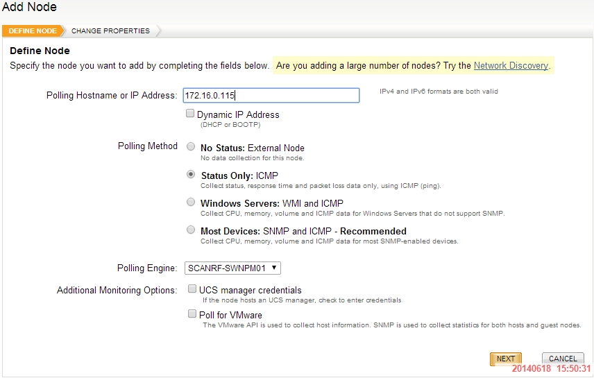

The Rajant device will be added to the Solarwinds NPM, either by means of a manual entry or a network discovery. In both instances the devices will be added via ICMP only and not via SNMP as the SNMP poll to the device will fail. One the device has been added the polling method will need to be changed manually to SNMP for every Rajant device on the network.
Adding a device manually

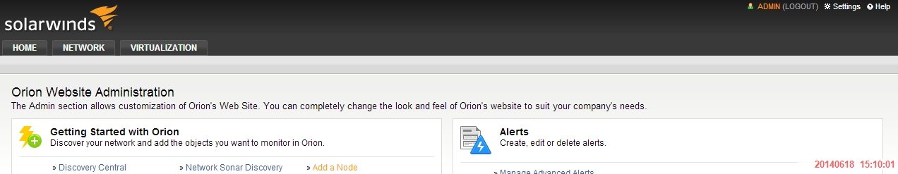

- Add device by clicking settings > Add a Node
- Type the IP address of the device in the IP address field

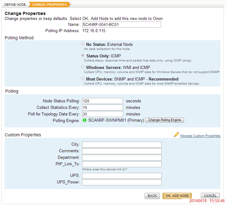

- Select the polling method to Status Only: ICMP
- Click Next
- Rename the device to something meaningful if necessary
- Click OK, ADD NODE
- Click OK after the device was added

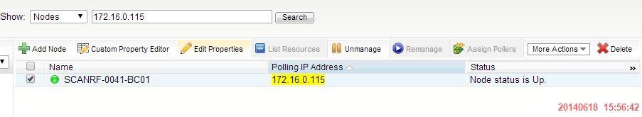

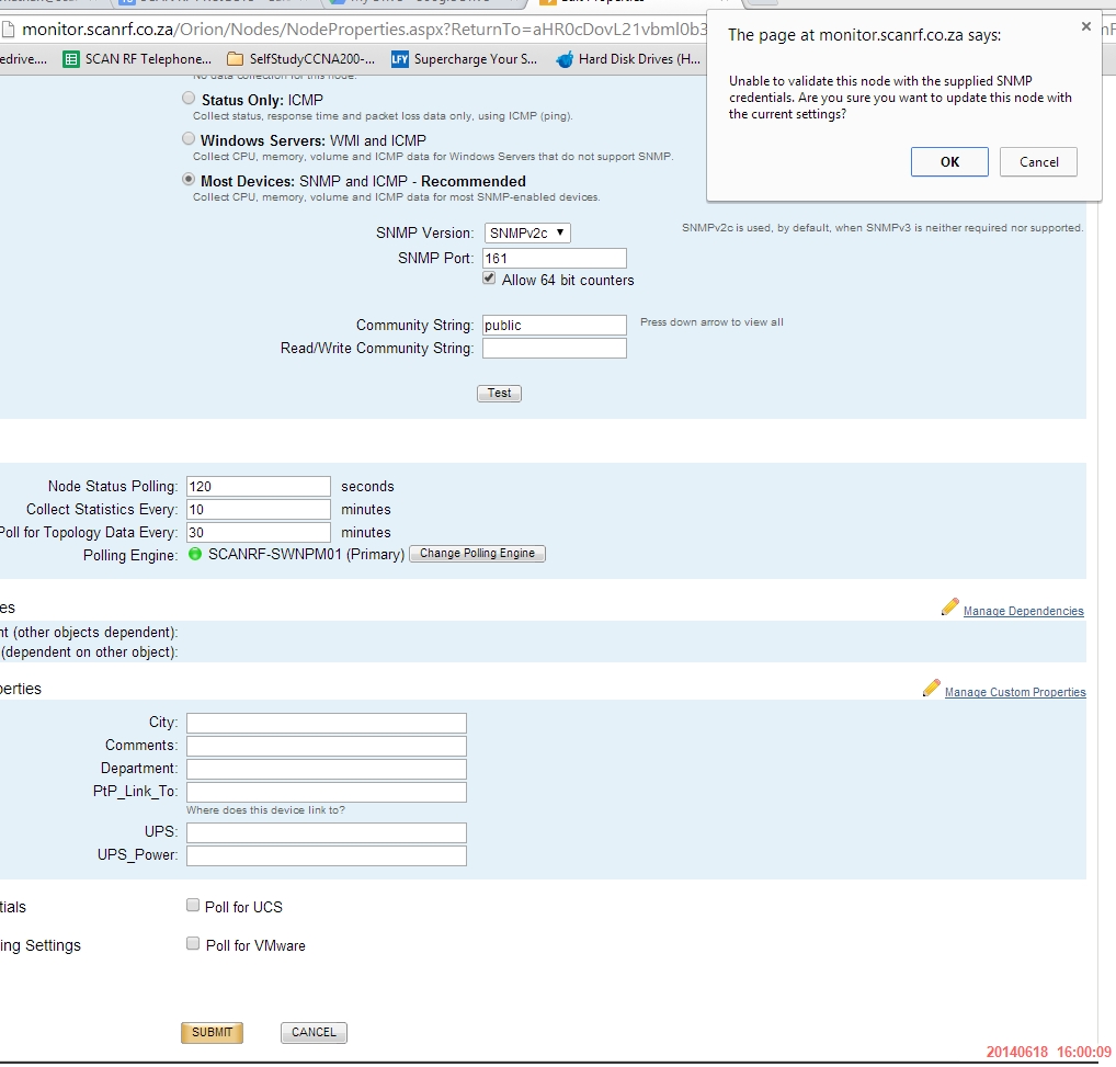

- In node management, find the device that was added and select the checkbox
- Click Edit Properties
- Change polling method to SNMP
- Check SNMP version and port are correct and tick “Allow 64 bit Counters”
- Type in public in the community string field
- Click submit
- Click OK on the error dialog when the credentials are not validated
- Adding of the Rajant device is now complete

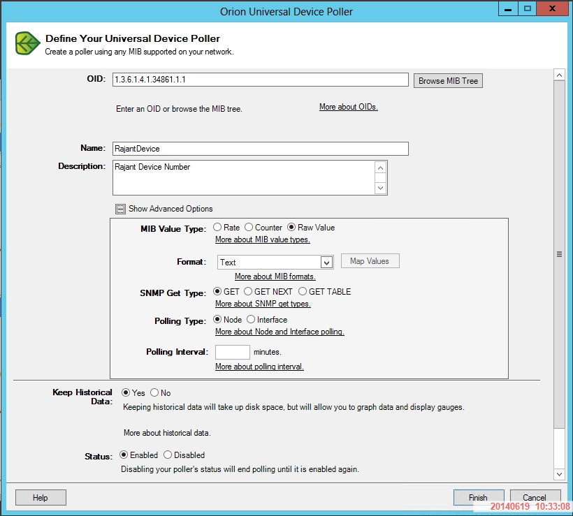

To add a universal device poller, one will need to work directly on the server where the application was installed and use the universal device poller application
Adding a universal device poller

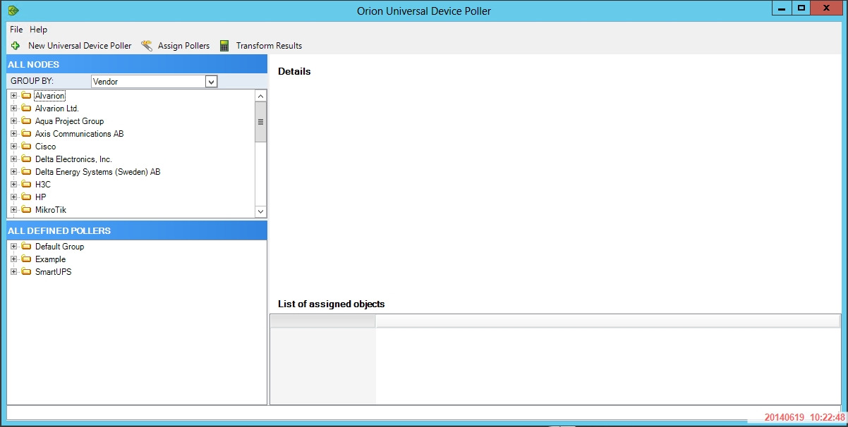

- Open the universal device poller application in the Solarwinds program group
- The application will then open
- Click on “New Universal Device Poller” and wait for the dialog box to come up
- In the OID field type in the OID for the specific statistic that information is required for 1.3.6.1.4.1.34861.1.1
- Provide a name for the poller
- Provide a description for the poller
- Click advanced options
- Set MIB value type to Raw Value
- Set Format to Text
- Set SNMP get type to GET
- Set Polling type to Node
- Click Finish

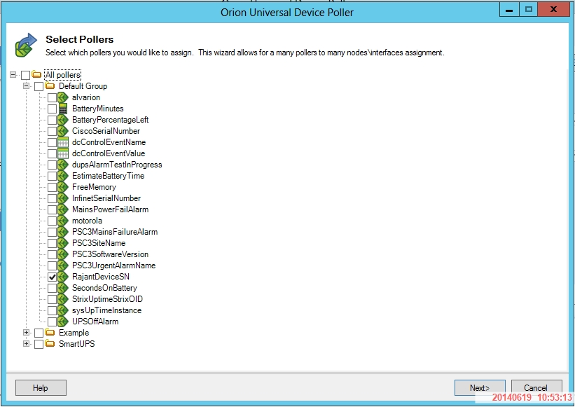

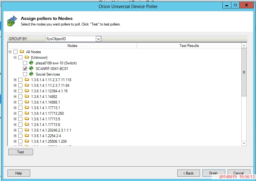

- Click on Assign Pollers and select the poller to use and click next
- Find and select the device to assign the poller to and click finish. To find the device easier, the “Group by” dropdown option may be used

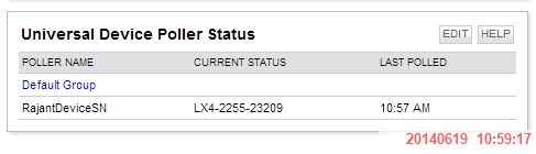

- The poller is now assigned and the information will be presented on the node details in Solarwinds
