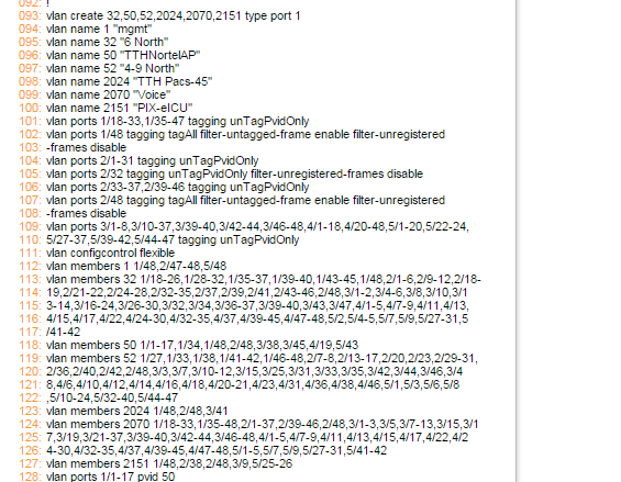

Anybody else experiencing this issue? I Googled a bit and didn't seem to find anything. Basically what happens is NCM reads in a config, and it's almost like it uses notepad with word wrap enabled- on long lines that would get wrapped in a narrow Notepad window, it places the rest of the line on a new line in the config. So what ends up happening, is that rather than "unwrapping" the line when it stores the config, it actually places the config line into separate lines. So for longer port-member statements and such, I'm getting 1 long line that NCM's stored config shows as 4 lines.
I swear I'm not insane. I just have no better way of explaining this. Example here- lines 113 through 117 should be one line, not 5. Similarly, lines 119-122, lines 124-126 are also affected. If I were to copy and paste this config into a switch, it would not work because those new lines are supposed to be one.
