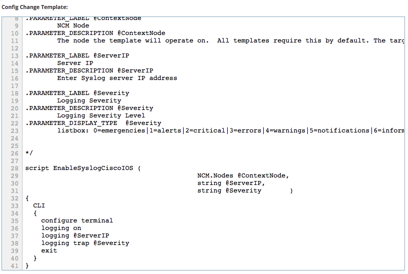

The "Enable Syslog - Cisco IOS" template consists of various parameters along with the CLI commands required to configure syslog:

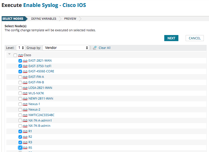

To start configuring your devices, you simply need to define the variables within the script and which nodes you'd like to apply this configuration to:

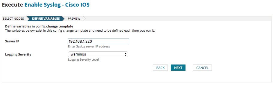

Once you've selected the nodes, you now specify the IP Address address of your Log Manager server, along with the logging level you'd like to apply. You should take some time to consider the appropriate logging level for your devices, as enabling low level logs such as informational or debugging can result in a high volume of logs being transmitted that may not provide value.

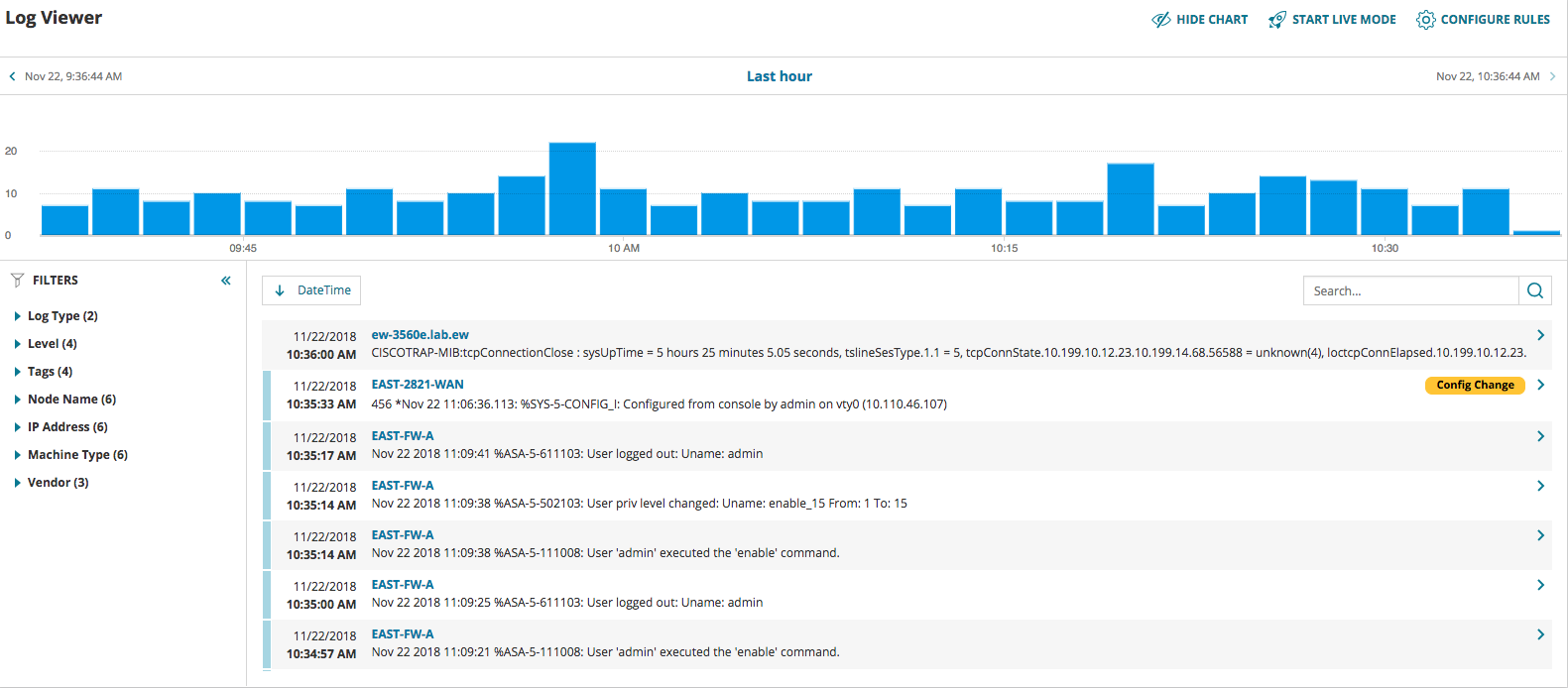

You are now ready to execute the script, or schedule the task to run at a later time. You can also confirm that the task has ran successfully via the Transfer Status page. Assuming the script has executed successfully on your selected nodes, you should now see your syslog appearing within LM's Log Viewer:
