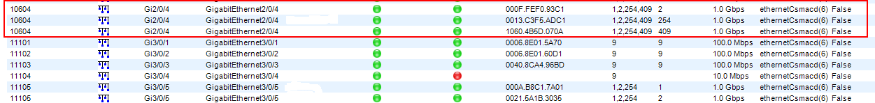

I am using Switchport Utilization on my switches and I have unchecked the option to display trunk ports.
When I look at the report I see trunkports showing up. I have a switch with 10 trunk ports, it hides 7 of the trunk ports
and displayes the other 3 trunk ports and says "trunkport=false"
Here is an interface configured as a trunkport that doesn't show up like it is supposed to:

The next 3 interfaces, which are trunk ports, show up in the report as not being trunkports.
