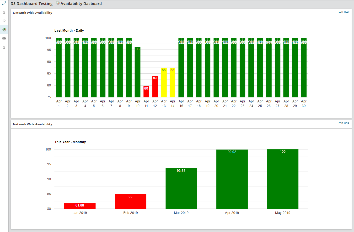

So a member of my team was working on a customer request where they wanted the default 'Network Wide Availability Chart' to show the values plotted on the chart so that when it was exported to PDF for management presentations they could see the actual numbers. Now, this isn't something SolarWinds is able to do out of the box. So we had to think "outside the box". After a quick chat with a fellow MVP wluther we came to the conclusion we could use Google Charts to accomplish this.
The end result should look something like this:
Multiple Charts Per Widget:
Multiple Widgets Per Page

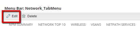

-Navigate to the "Custom HTML" resource you want to display the calendar.
-Click Edit.

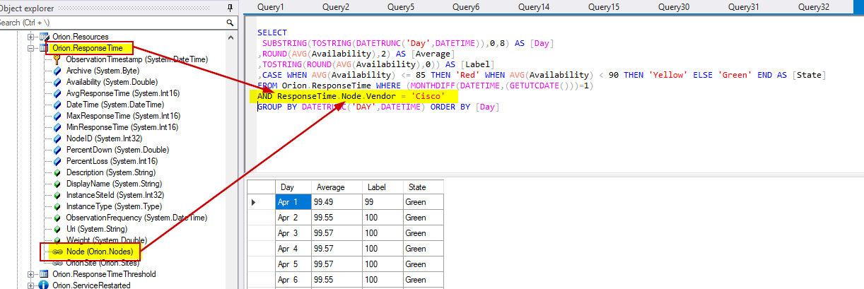

This is in essence, just a simple Vertical Bar Chart using an SWQL Source to populate the data. If you want to present different data then just go ahead and update the query, and the chart should reflect it too. The query I used was situational, and could easily be updated to add filters or provide additional or totally different data. The two queries I used are as follows:
SELECT
SUBSTRING(TOSTRING(DATETRUNC('Day',DATETIME)),0,8) AS [Day]
,ROUND(AVG(Availability),2) AS [Average]
,TOSTRING(ROUND(AVG(Availability),0)) AS [Label]
,CASE WHEN AVG(Availability) <= 85 THEN 'Red' WHEN AVG(Availability) < 90 THEN 'Yellow' ELSE 'Green' END AS [State]
FROM Orion.ResponseTime WHERE (MONTHDIFF(DATETIME,(GETUTCDATE()))=1)
GROUP BY DATETRUNC('DAY',DATETIME) ORDER BY [Day]
AND
SELECT
CONCAT(SUBSTRING(TOSTRING(DATETRUNC('MONTH',DATETIME)),1,4),SUBSTRING(TOSTRING(DATETRUNC('MONTH',DATETIME)),8,4)) AS [Month]
,ROUND(AVG(Availability),2) AS [Average], TOSTRING(ROUND(AVG(Availability),2)) AS [Label]
FROM Orion.ResponseTime WHERE (YEARDIFF(DATETIME,(GETUTCDATE()))=0)
GROUP BY DATETRUNC('MONTH',DATETIME) ORDER BY DATETRUNC('MONTH',DATETIME) ASC
