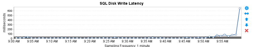

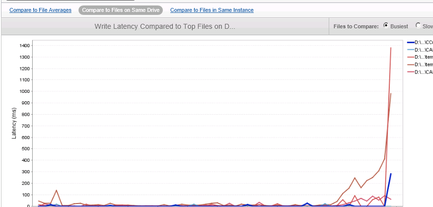

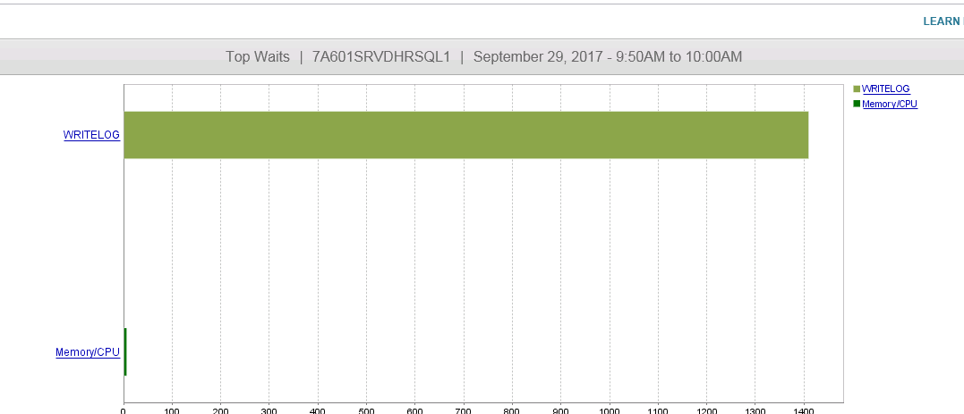

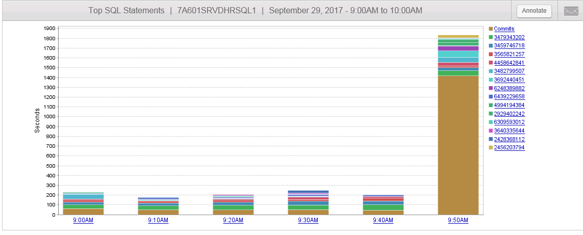

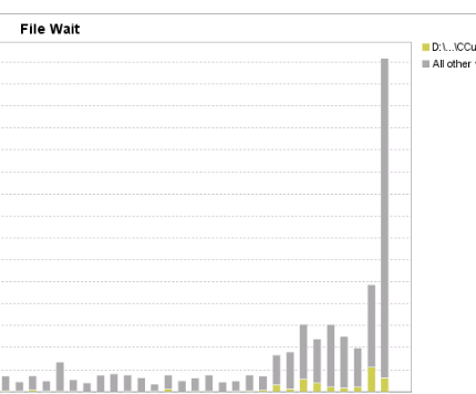

We've started using DPA on one of our clients sites and it's helped us a lot by highlighting some issues with some problem queries, we've now hit a bit of a roadblock because the top SQL Statements is now being listed as "/* Commit */" and i have no idea what that means or where it's coming from. When this happens the users see 30+ second delays on the DB for the simplest of queries.
To give an example the application will run normally and then hit a commit

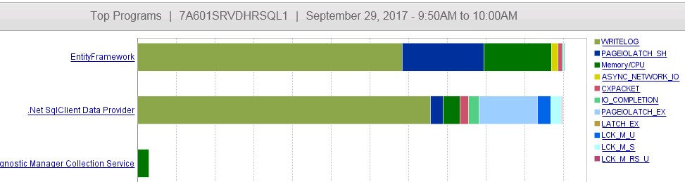

So the wait type is write log, and both the web service and website that utilse the db are "triggering" it. I'm at a loss to what the commit actually is??
I'm looked at the help guidelines and it hasn't really got me any further.
We're using Entity Framework so I would have though that if it was that causing the issue i would see some reference to the query that caused the commit.
