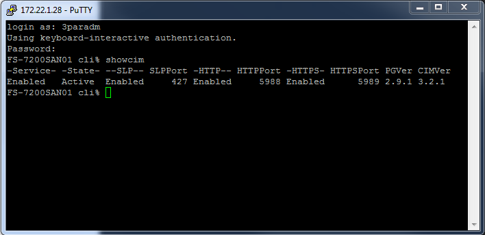

During troubleshooting, I removed the SAN from SRM to re-add it. Once we figured out what the real reason was for no longer being able to communicate with the controllers, I wanted to re-add the SAN back to SRM and we're all set.
We didn't change any settings and we're using the same IP address. VSP is working again and so are the reporting services. We also made sure the SMS-R service (CIM) is enabled and running.

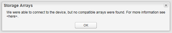

But every time I attempt to re-join the 3PAR to SRM I get the weird error below:
"We were able to connect to the device, but no compatible arrays were found. For more information, see <here>."
Any Ideas???
