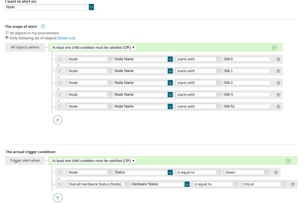

I've got a Node alert working for node up/down events and i'd like to extend it to show hardware component details such as power supply status.
I've created a node event that I know triggers:
The trigger action is to send an email with the message body:
An issue has been detected at ${N=Alerting;M=AlertTriggerTime;F=DateTime} on ${N=SwisEntity;M=MachineType} device named ${N=SwisEntity;M=Caption} (IP: ${N=SwisEntity;M=IP_Address}, DNS: ${N=SwisEntity;M=DNS})
View full device details here: ${N=SwisEntity;M=DetailsUrl}.
View full alert details here: ${N=Alerting;M=AlertDetailsUrl}
Click here to acknowledge the alert: ${N=Alerting;M=AcknowledgeUrl}
HW details:
Alert ${N=Alerting;M=AlertName} at ${N=Alerting;M=AlertTriggerTime;F=DateTime}
${N=SwisEntity;M=FullyQualifiedName} is ${N=SwisEntity;M=Status;F=Status}
This message was brought to you by the alert named: ${N=Alerting;M=AlertName}
The node is monitored by the polling engine ${N=SwisEntity;M=Engine.ServerName}
However, the actual result simulation (on a node with a failed PSU) just shows:
An issue has been detected at Thursday, 11 April 2019 10:15 on HP 3800 Switch Stack device named SW-203-03-013-01-01 (IP: 10.152.0.21, DNS: )
View full device details here: https://SWIN.FQDN:443/Orion/NetPerfMon/NodeDetails.aspx?NetObject=N:52.
HW details:
Alert TEST of ## Node is DOWN/UP - Switches SMS Day Hrs at Thursday, 11 April 2019 10:15
${N=SwisEntity;M=FullyQualifiedName} is Up
This message was brought to you by the alert named: TEST of ## Node is DOWN/UP - Switches SMS Day Hrs
The node is monitored by the polling engine SWIN
Can I only solve this with SWQL? If so, does anyone know what I would look for?
I can workaround this with a specific hardware alert, but that will result in another duplicate set of actions to manage, using the action manager to enable/disable alerts to the individual engineers.
Any ideas will help!
Thanks
Glen.
