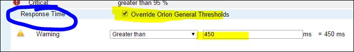

OK, I know, I know... NPM platform does give you a way of overriding global thresholds per node through "Edit Node" properties.

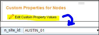

Here is the only thing which is needed to be done by Engineering Team - set Site ID custom property. That's it:

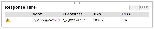

Here is what you will get:
Main resource for your Summary NOC page:
If everything is OK - it will show nothing
However, as long as there are some issue - they will show up here:

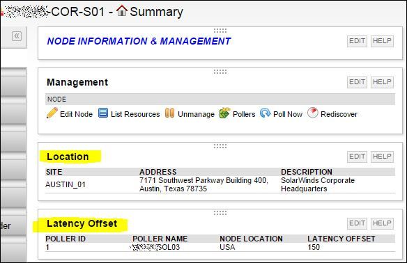

Few additional informational resources for the nodes's summary page so that you always have these location details on hand when you land on any node:

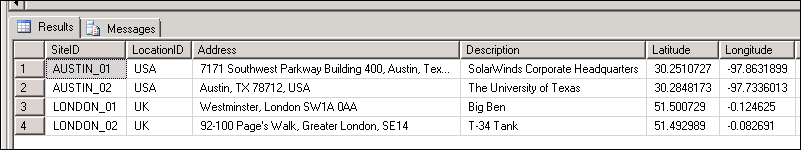

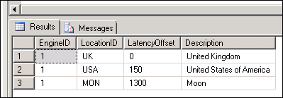

Populate tables with your site details
SITES TABLE
LATENCY OFFSET TABLE
* Notice that LocationID will be joining link between these two tables.

Download the above SQL as a ready-made report and import into Orion Report-Writer.
Add this report as an on page resource on your NOC page

Bonus. Now, let's create few more reports for the node summary page:
SQL source for Location
SELECT Sites.SiteID AS 'SITE' ,Sites.Address AS 'ADDRESS' ,Sites.Description AS 'DESCRIPTION'FROM SolarwindsAux.dbo.SitesINNER JOIN Solarwinds.dbo.Nodes n ON n.n_site_id = Sites.SiteIDWHERE n.Caption = '${Caption}'
SQL source for Latency Offset
SELECT Nodes.EngineID AS 'Poller ID' ,e.ServerName AS 'Poller Name' ,s.LocationID AS 'Node Location' ,lo.LatencyOffset AS 'Latency Offset'FROM Solarwinds.dbo.NodesLEFT JOIN SolarWindsAux.dbo.Sites s ON Nodes.n_site_id = s.SiteIDLEFT JOIN SolarWindsAux.dbo.LatencyOffset lo ON lo.LocationID = s.LocationIDINNER JOIN Solarwinds.dbo.Engines e ON Nodes.EngineID = e.EngineIDWHERE Nodes.Caption = '${Caption}'
* you will find both reports attached as well.
Same as above - just add them as a resources on your node summary page
