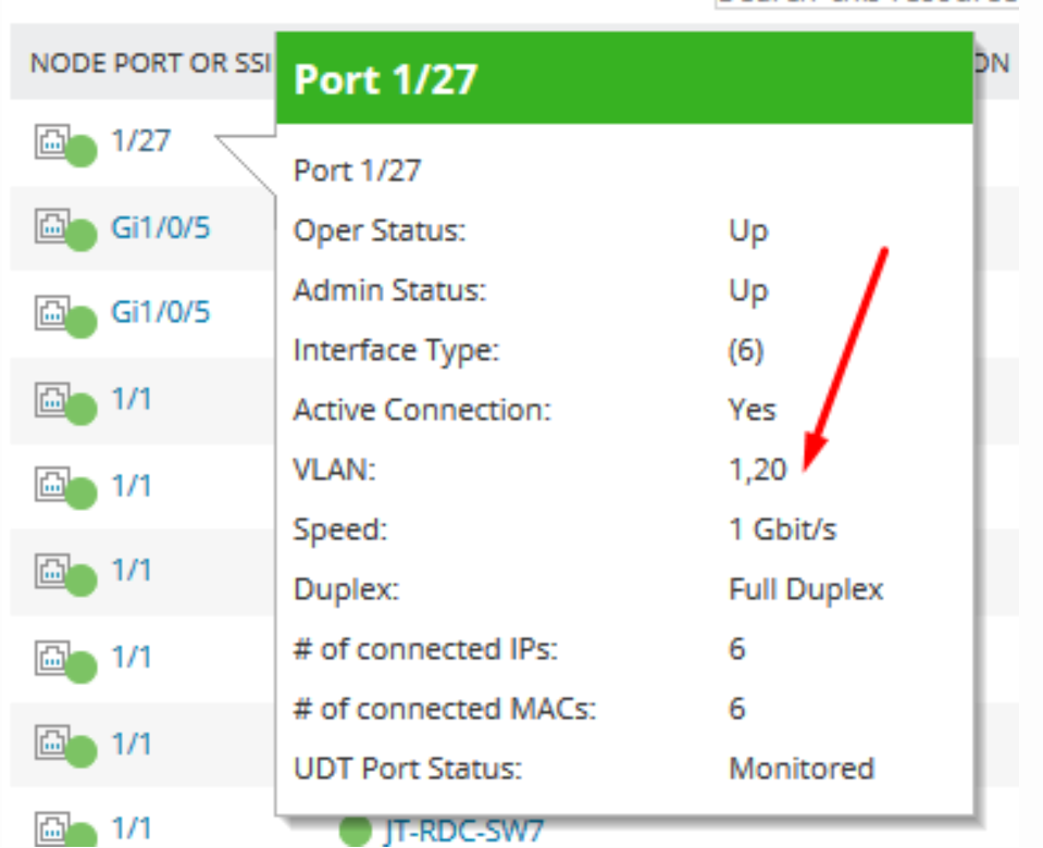

except, when I look at the UDT page of the switch, I see "Vlan 1" on the very right column
And the issue is that I see VLAN 1 on every ALCATEL access port (amongs hundreds switch, whatever the switch and whatever the port)
|  |  | 1/27 | | 10.20.0.x | | 64:00:6A:4F:AB:CD | 1 | |
| | | | | | 10.20.3.x | | 48:4D:7E:F0:xx:xx | 1 | |
| | | | | | 10.20.7.x | | 00:21:B7:2E:xx:xx | 1 | |
| | | | | | 10.20.0.x | | EC:B1:D7:D9:xx:xx | 1 |
Whick makes the UDT module very not usefull
What is really frustrating is that I see however "1,20" (as follow) when I move the mouse over the port number, but not 20 (or at least 1,20) at the end of the column in the UDT Table.
Solarwinds support tells me that my switchs (Alcatel 6850) might not support the OID requested... but first I don't think I have control over this OID value,
and second I can't believe that more than 100 Alcatel switchs do not follow SW MID standard...
I knew that Solarwinds was not entirely compatible Alcatel, but for such a basic function I don't believe there's no solution.
Does anyone meet the same issue ?
