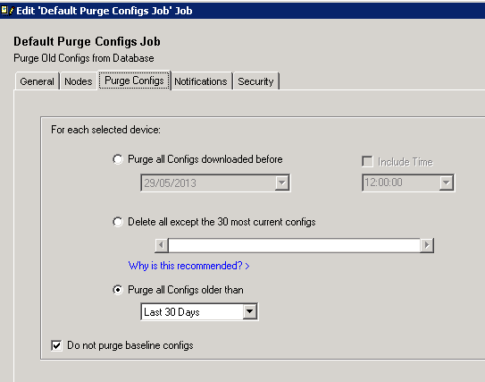

there are various scheduled jobs in the NCM GUI you can safely run.
There should be one called 'default purge configs job', You can alter the job and tweak it to purge only the configs you want.
I have requested the functionality to split running and startup and a few other bits into this job - i believe this request is currently under consideration.
To get around this isssue I mark all configs i wish to keep temporaily as 'baseline' using a simple SQL script - then the purge jobs delete all the configs i have not marked etc
Thanks for the reply. This only allows to purge based on the time frame the configuration was backed up and gives an option to either purge or not purge the baseline config.
But if you want to keep startup configs and purge only running configs that are xx days old ... you don't have an option to do so.
