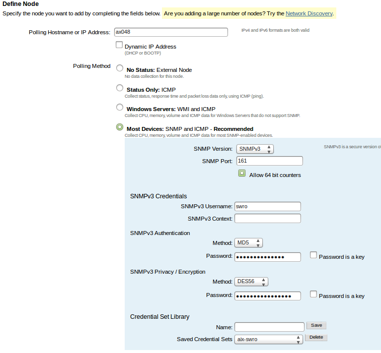

Solar Winds Configuration
It should now be possible to add this node in Solarwinds.
Key Values
- SNMP Version: SNMPv3
- SNMPv3 Username: swro
- SNMPv3 Authentication Method: MD5
- SNMPv3 Authentication Password: Use the password from pwtokey above (don't use the key, it doesn't work)
- SNMPv3 Privacy Method: DES56
- SNMPv3 Privacy Password: Use the password from pwtokey above (don't use the key, it doesn't work)
Hit the test button to see if all is ok. If it isn't make sure the services have been started and check the snmpdv3.log for more clues (especially the "did solar winds get here at all" clue).
