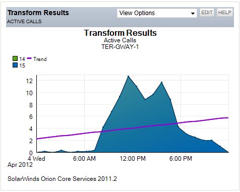

I have H.323 gateways on Cisco 2901 routers. Here is how I did it. In Orion Universal Device Poller I click on New and used the OID 1.3.6.1.4.1.9.9.86.1.2.1.1.8
Then, I clicked on the new poller to highlight it and click the transform results button up top. I used the following formula columnsum( {cdspActiveChannels} )
This gather my active calls per PRI line and summed them up. Then I clicked on the transform results poller assigned them to my routers and enabled web display.
It looks like this. Number 14 and 15 are my two PRI Lines. The transform results adds them together and then display them both but the data is the same.
Looks like my highest call volume is during lunch and a little before the end of the day. I guess everyone is calling home to make plans
