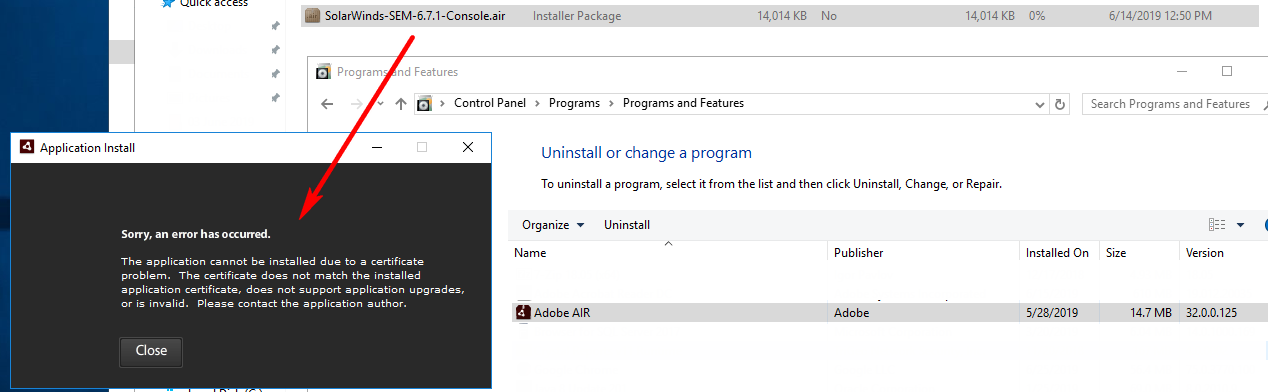

When trying to install the latest AIR Console for SEM management (version 6.7.1), I get the following error:
I have the latest stable release of Adobe AIR (version 32.0.0.125)
Any hints or only a support case can resolve this ?
Thanks
Unless the new version has a bad certificate in the build (which support would likely have to confirm) you can try these steps:
Success Center
That was correct.
The bad thing is that upon uninstall/reinstall of local desktop console, you have to go all over the Scheduled Searches and add the schedule again.
Importing them does does not save their scheduled run time too.
