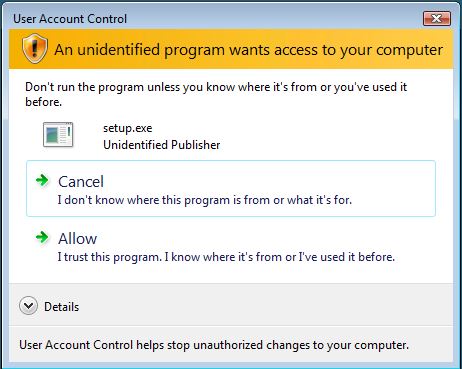

When this package runs on computer needing the package it completes in a few seconds and Windows Update states it was successful and then the package it ready to installed again by Windows Update (because MatLab wasn’t installed). Watching Task Manager shows that setup.exe (from the network share) runs for a couple seconds and then quiets and there is nothing in the Windows Event Logs to indicate what is occurring.
