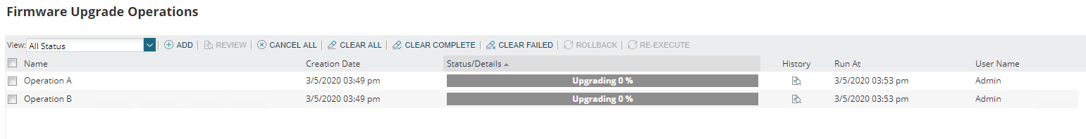

Parallel firmware upgrade operations are now possible with 2020.2 NCM! You asked and we listened
NCM Firmware upgrade operations now can run in parallel instead of sequentially as it was before.
Upgrade on individual nodes in the scope of single operation still run sequentially. Running parallel upgrade is possible only if you create two or more separate operations.
How to use the feature
Create two or more Firmware upgrade operations with your own unique set of nodes for each one. These operations will run in parallel which will speed up the total time needed for an upgrade.

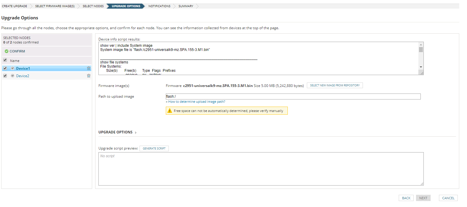

We redesigned the Upgrade Operation Options wizard step to allow easier confirming of nodes. There's no longer a need to click on every node to confirm. (thank goodness right?) You just select multiple nodes on the left side and click the confirm button:
