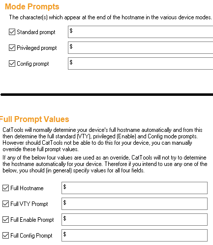

I have configured variations as follow for the JUMPHOST:
And still not working, please see debug below:
