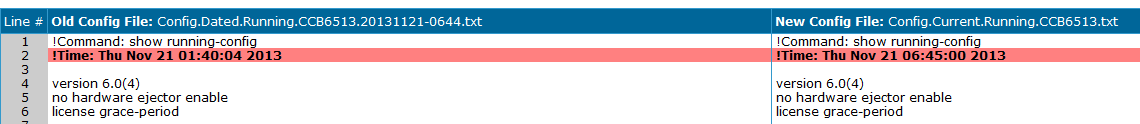

I know we can use some compare criteria in the reporting of "Report.Compare.Running.Startup" type, or when we manually compare two files - but what do we do about those options when using the "Device.Backup.Running.Config" job type?

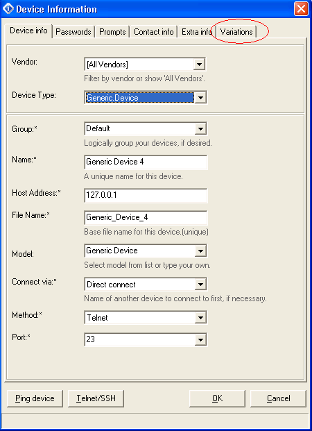

Since we cannot modify the pre-canned scripts, I don't see any way to add a filter of any type - for example, I want to exclude anything starting with a ! from the compare. Is it possible only in NCM?
Example:
