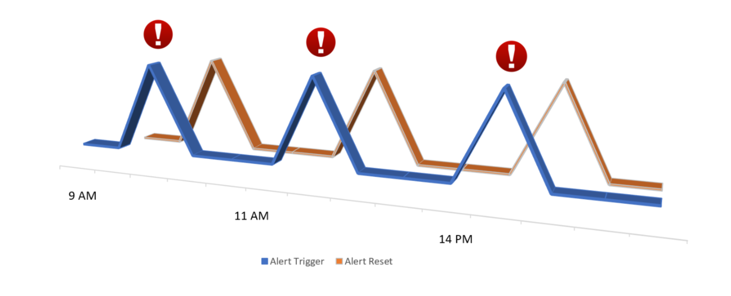

firstly the problem is that when an alert triggers it will eventually reset, my issue is that it could reset straight away and before you know it another trigger, ramping up the ticket count, incorrectly logged tickets and missed alerts. solarwinds ships with some cool features to help prevent alerts with some advance logic but this will require making a few dozen additional alerts,
for the purpose of this article ill just use node status as the alert condition
just below, the scenario is noisy alerts. the first trigger is at 9 then reset, then an alert at 11 then reset, then alert an alert at 2 and so on... you could simply say in the alert reset condition node must be UP for x minutes or hours before resetting then re-triggering some time later.

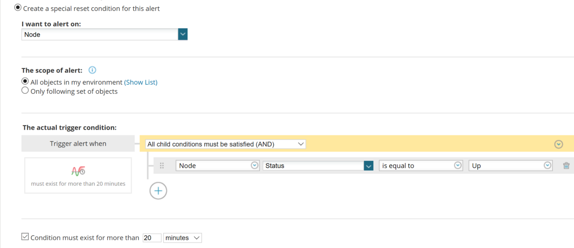

I don't really like this static value and to change this I would need to create another alert with different times, opting for this type of alerting will require making duplicates of interfaces alerts, volume alerts,node status basically everything, at this point things start to get messy specially when you implement your workflow else where, if like me i just want 1 single alert.

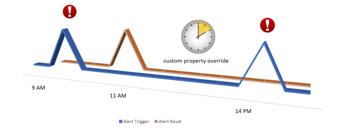

Just to recap, i want an alert to trigger then reset then a custom property delay then alert before the next trigger, seems reasonable enough. the logic for the alert is simple really, just check events from previous alerts and if the current time is greater then the custom property of the last trigger then alert.

due to this type of logic for the trigger if the device is down for longer 16 hours then it will reset regardless of node status because the 16 hours have passed resetting the condition. so what i use for node status resets alerts is to check for the actual node status, like this:

that's pretty much it, now once you set a value in the custom property 'n_hrs_delayNetTrigrStatus' on the node details it will check the events in future before triggering just like below.
