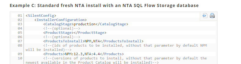

The goal is a silent install of NPM and NTA. Using instructions found: Run the SolarWinds Orion Installer in the silent mode - SolarWinds Worldwide, LLC. Help and Support I am able to get NPM to install correctly, but adding NTA to the list of modules be included prevents the configuration wizards from being executed. (all modules installed, but need to be configured to work).
The XML example at the above URL does not show how to specify the NetFlow Database information. I suspect this is the problem I am hitting.
I am using the NPM-12.3 Offline installer binary to execute the install.
