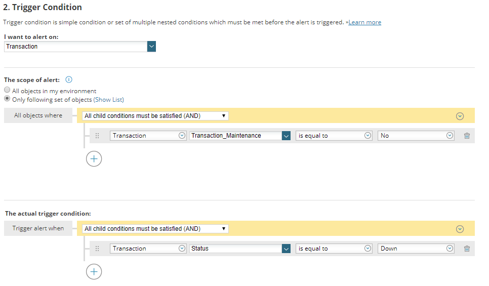

So it looks like Transactions don't support the "Mute" function. Off the top of my head, I would try the good old fashion Custom Property that was used years back and add that to your alert trigger condition.
I've used an example called "Transaction_Maintenance" with a Yes/No value - I've set one of my Transactions (which happens to be down) to YES, then I've edited the Alert Logic as follows:
Let me know if this is enough? The only challenge I can see is changing that CP Flag to YES in a Scheduled manner. You could use an alert to change the CP based on TOD, or use an external script - That's a different issue lol!
Simplistic genius!More then enough bud. I got you at custom properties. Can easily just change these
