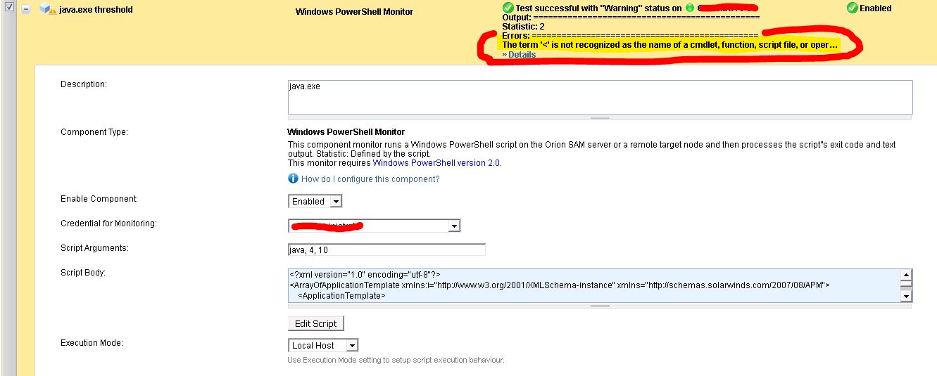

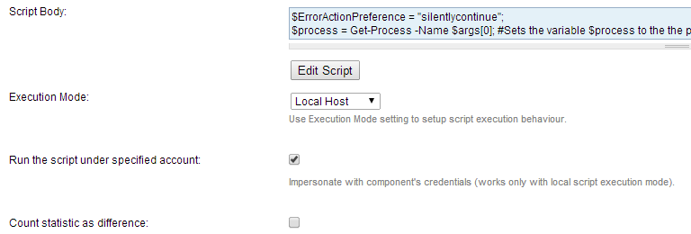

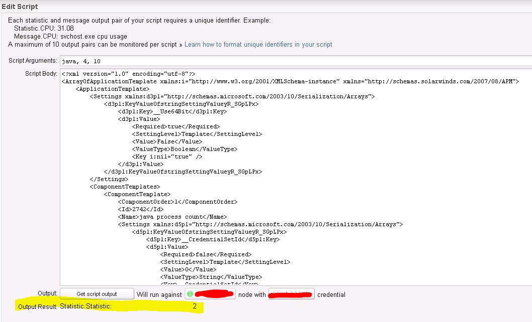

Every time I run a test from within SAM I get the same count -- 0. I've connected to my remote poller (and yes, my test node is on that remote poller, not another poller) to I am able to query the test server using PowerShell and WMI (wbemtest or WMI Explorer) and they return the correct values and/or counts. I am currently using a Windows Powershell Monitor with the code below and with the component set up as follows:
And I still get the following when I test -- any ideas?
