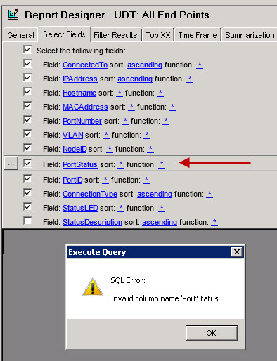

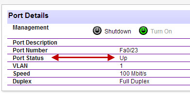

Well one problem we have is we have devices that don't populate MAC or IP but they still show the interface being up(UDT - Portstatus). So I took a look at the canned report UDT Connected Device > Active Endpoints (per node) report in report writer. Its the perfect report for our needs, I can add filters to get it down to one data closet at time however the output seems to require something being in the mac address field.
So right now I am looking at the report and its skipped over a port that I know to have an ASA5505 plugged into it, and in UDT under that switch it shows the port status as UP. So I tried to add the "PortStatus" to the Active Endpoints (per node) report and it throws a "Invalid column name 'PortStatus'."
Is there a way to get this value into the report without having to completely rewrite the report in raw SQL?
