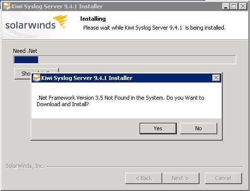

IIS is not installed, however every single time I have to run the installer it tells me that the .Net Framework 3.5 is not installed (even if it was installed previously) and asks me if I want to install it. If I say No, the install closes and fails. If I say Yes, I have to sit through it downloading a 231 MB file, which even on a 3 Mb connection takes almost 10 minutes.
Jiri, with all due respect, this is flat out wrong. I just upgraded from 9.4.0 to 9.4.1, with the Web Interface options unchecked and was prompted once again to install .NET 3.5.

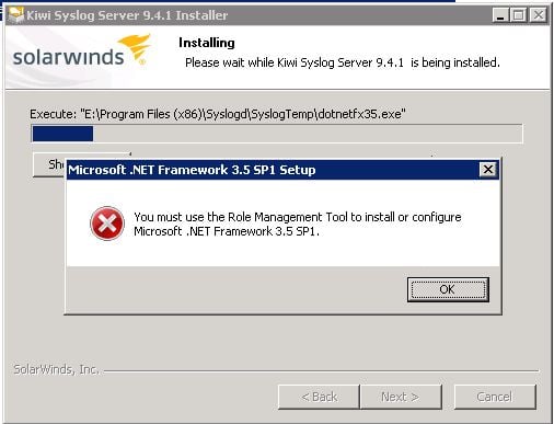

If I click NO, the Install stops and says it failed. If I click YES, it downloads, then tries to install, then I get this:
I would be delighted to show any of your development folks this if they care to see it. If it sounds like I'm frusted, I am. I've been dealing with this for what seems like a year now.
