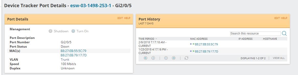

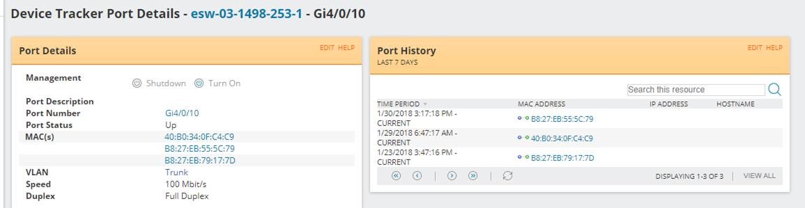

Trying to figure out what’s going on, there seems to be some inconsistencies. One thing that’s bugging me is something I’m seeing in the Port Details in UDT. I have 2 ports in my office that I’m using, there is no switch/hub hooked into them, so at the most I should be seeing a single MAC address on the port at any given time. However, UDT is reporting multiple MAC addresses on them. I have confirmed via the command line that at the time of this polling there was a single MAC address on the port. Furthermore, one could argue that if a port is “down” that there should be no “current” MAC-addresses on the port. Now, it might take a little time for the switch to age out the MAC address from its table, but no more than 5 minutes. But even when Orion is knowing that a port is down for quite a few polls, it’s still showing MAC(s) on the port. To me, both of these are telling me that UDT is not actually reflecting the current state of the port, which is bad.
This seems to be causing issues with the “Port History” shown here also. Of the 3 MACs on Gi4/0/10, only the one ending is 17:7D is current. But yet both switchports, the one that is UP and the one that is DOWN, are showing multiple MAC as being “CURRENT” in the “Port History”, not good.

But as you can see, its showing this MAC as active on two different ports on the same switch. This should never happen, a mac address-table on a switch associates a given mac to a single port. But even though gi2/0/5 is down and Orion knows it is, it’s still registering the same mac on two different ports of the same switch. Not good. The port that is down should show no current MAC addresses.

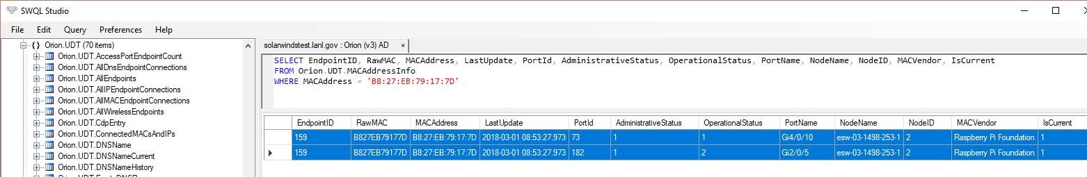

I think this is what is causing issues with the MAC MOVE alert. I was going to write a custom report to show the MAC’s that had moved in the previous day, and while working in SWQL studio I saw the following. When I looked for the MAC I’m playing with, it shows as being “IsCurrent” on two different ports at the same time on the same switch. Once again, bad. You can also see from here that the operational status on one of the ports is “2” which is “DOWN”. A “DOWN” port shouldn’t have any active MAC’s for any extended period of time.
