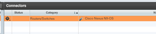

There should be a connector on your appliance that supports NX-OS logs:
If you follow the steps in the guide you attached, but simply apply the above connector, rather than the Cisco PIX & IOS connector mentioned in the guide, LEM should then pickup the Nexus logs.
Any problems/questions let me know
