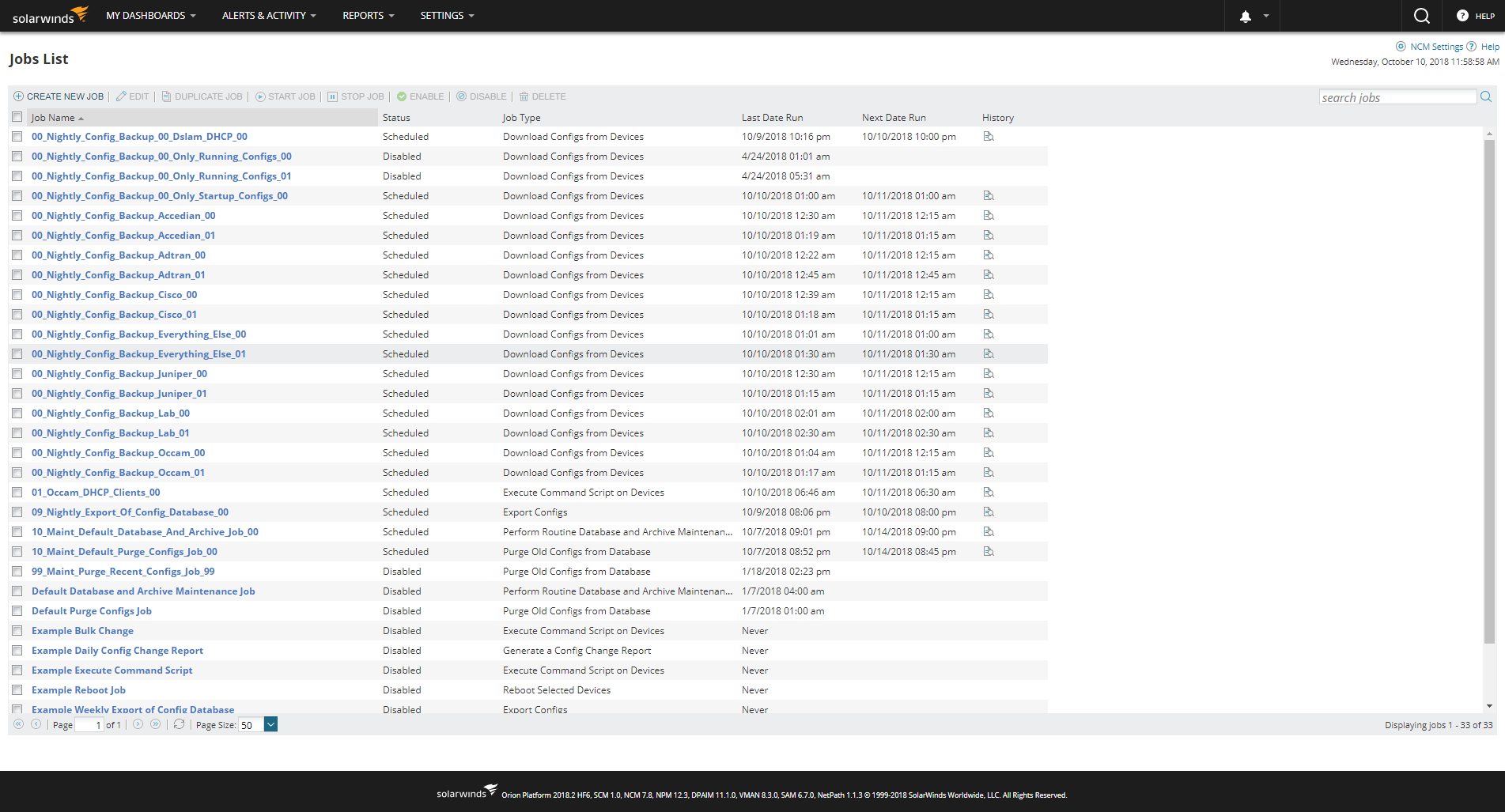

This is what the default NCM Jobs List page looks like:
