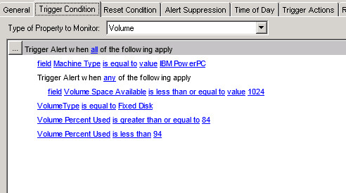

For whatever reason I cannot get this to fire. I believe I have the trigger set correctly. Thoughts?

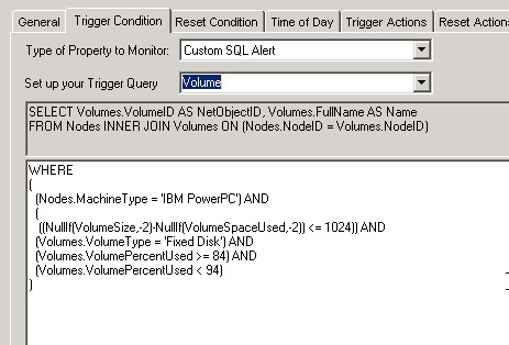

Can you change the drop-down option to 'Custom SQL Alert' and then post a screenshot of the full query?
Sure thing...
You're problem here is your grouping level.
You have the following under your ALL condition
MachineType = 'IBM PowerPC'
VolumeType = 'Fixed Disk'
VolumePercentUsed >= 84
VolumePercentUsed < 94
And the following under your ANY condition
VolumeSpaceAvailable <= 1024
So right now this will only trigger if the Machine type is equal to exactly 'IBM PowerPC' AND the VolumeType is exactly 'Fixed Disk' AND the VolumePercentUsed is greater than or equal to '84' AND VolumePercentUsed is less than 94 AND VolumeSpace Available is less than or equal to '1024'. The way this is currently configured there is no need for the ANY statement.
When you add new basic or complex condition you need to make sure that you have the condition group you want it under highlighted. The up/down arrows or right-click commands do not change the condition group a statement is in... it just moves it vertically in the list.
This is a very specific logic and considering the size of fixed disk drives it is unlikely that you'll have a volume with between 84 and 93 percent utilization that has 1024 or less bytes of space available.

For this drive
The following is stored in the Volumes table (the table being used in the alert select)

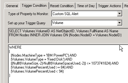

Totally makes sense now. I've removed the "any" statement and converted to bytes.The reason for the < 94 is that I created a second critical alert for > 95 and didn't want to double dinged with two alerts. So logically this should fire
