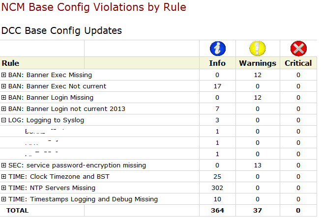

I have two reports that are emabedded into a summary report.
Report1 - NCM Base Config Violations By Rule.rdl
TOP (100) PERCENT dbo.Nodes.NodeCaption, p.ReportName, p.RuleName,
SUM(CASE errorLevel WHEN 0 THEN 1 ELSE 0 END) AS Info,
SUM(CASE errorLevel WHEN 1 THEN 1 ELSE 0 END) AS Warnings,
SUM(CASE errorLevel WHEN 2 THEN 1 ELSE 0 END) AS Critical
dbo.PolicyCacheResults AS p INNER JOIN
dbo.ConfigArchive ON p.ConfigID = dbo.ConfigArchive.ConfigID INNER JOIN
dbo.Nodes ON dbo.ConfigArchive.NodeID = dbo.Nodes.NodeID
WHERE p.IsViolation = 1 AND (p.ReportName = 'DCC Base Config Updates')
GROUP BY p.ReportName, p.RuleName, p.ReportID, dbo.Nodes.NodeCaption
ORDER BY p.RuleName
.rdl file attached. This is using expandable list so that you get a nice report showing the totals per level/warning.
