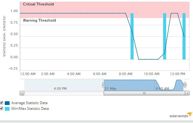

The 0/1 state of yes-or-no-ness:
On an aside, it would be nice to have left axis values of 1 or 0 instead of decimals and negative numbers.

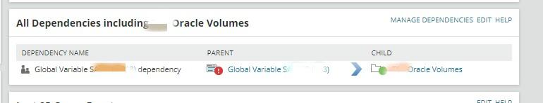

The custom property, defined in a parent:child relationship in order to not alert on say, disk space, when an install might use the entire disk when it runs.
It worked like I wanted, to a limited extent, as I hit a few bumps. I've read that the parent of the group needs to be singular, or alarms might skirt this gate. And, the custom property does not look like it scales a lot as I've seen this example show up in other places. A couple hundred settings might turn into noise if variables cover many apps. Last, when I set the variable back up from the AutoSys side the child disk volumes have remained in a grey/unknown un-monitored state. Of course, that could be for other undiscovered reasons.
