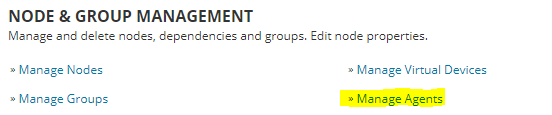

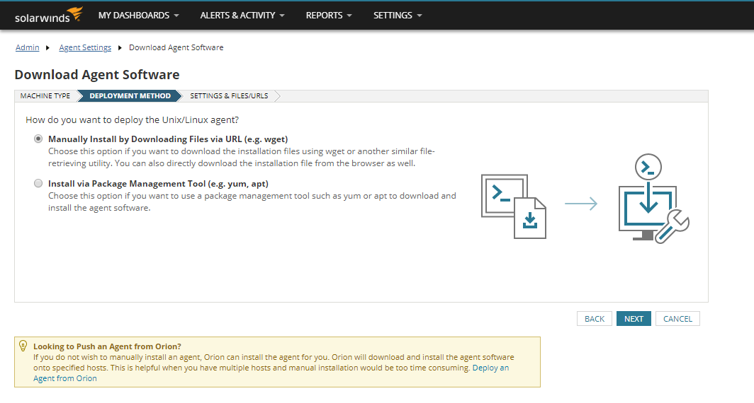

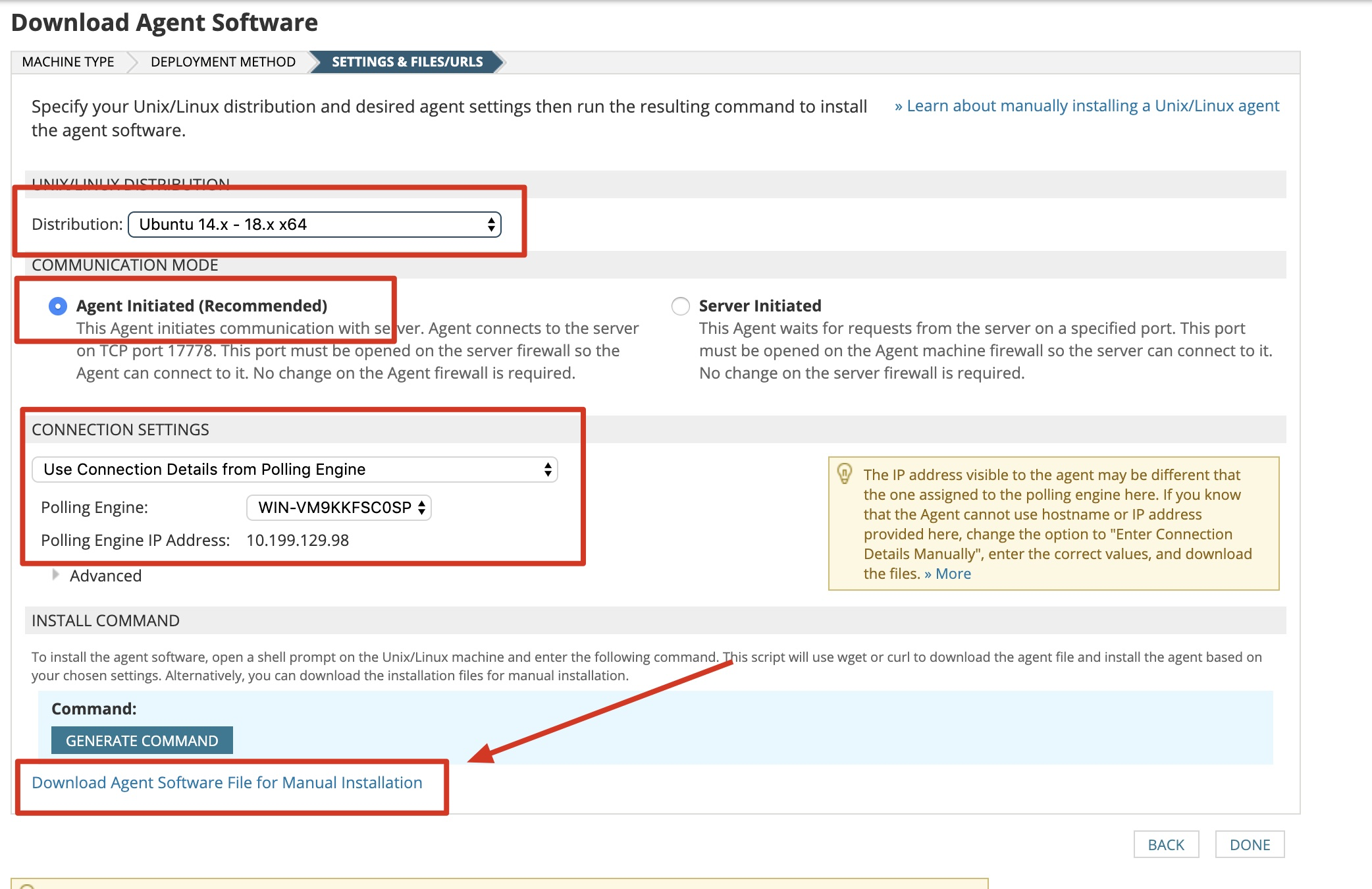

1. Open your SAM web console and navigate to 'All Settings' -> 'Manage Agents'

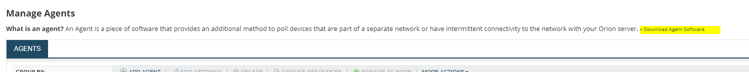

2. On this page, you'll see a link to 'Download Agent Software' in the upper right hand corner.

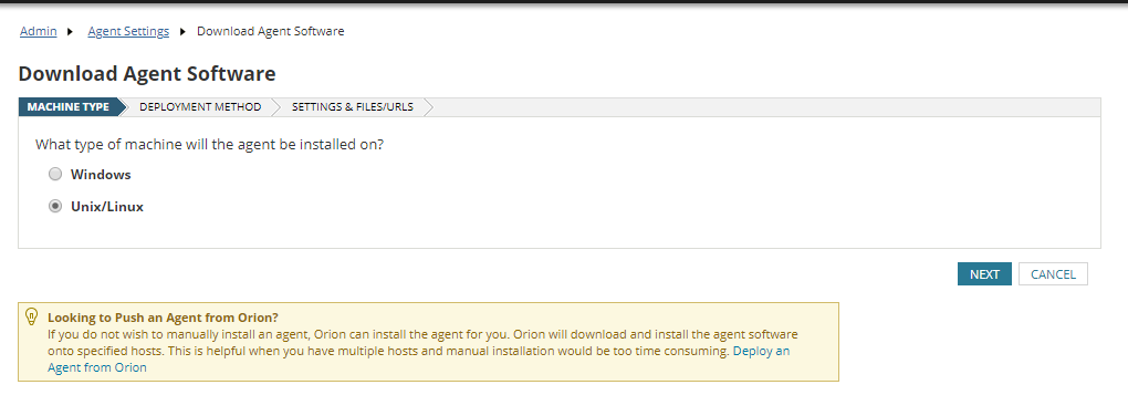

3. Click through the wizard by selecting 'Unix/Linux'
4. and then 'Manually Install by Downloading Files via URL'
5. On the 'Settings & Files/URLS' page, you'll be able to download the necessary tarball.
6. After downloading this tarball, you'll want to ensure it's downloaded or copied to your Linux server.

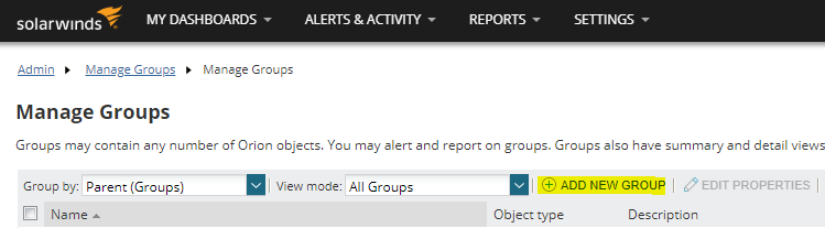

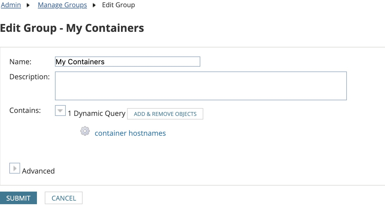

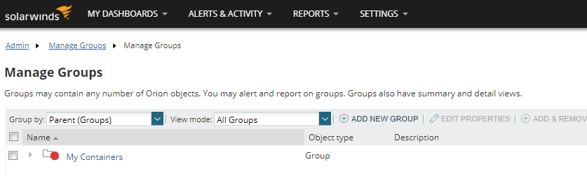

Navigating back to your SAM web console, click 'All Settings' -> 'Manage Groups'

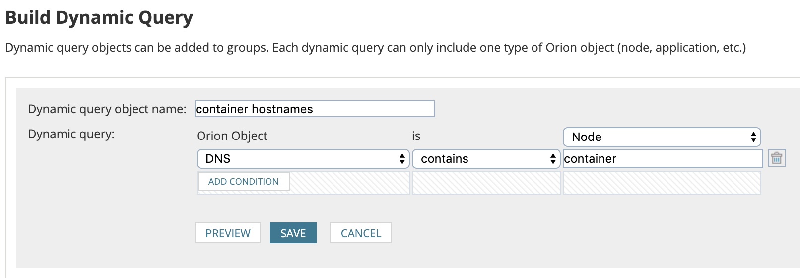

From here you'll create a dynamic group utilizing a dynamic query.
In this instance, the dynamic query is identifying the container by its hostname.
Your group is created and is ready to be assigned a SAM application template.

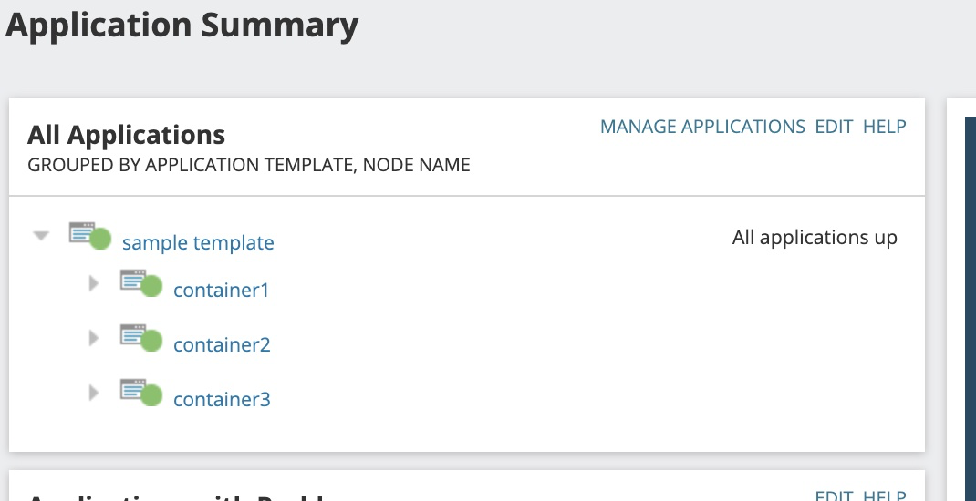

Assign / Create SAM Application Template(s)
SAM has hundreds of OOTB application templates (See: Welcome to the SAM Template Reference ) but even better, there is a robust community of systems administrators that have created and contributed templates right here in THWACK. Choose one of the OOTB, community written or your own custom application template to be assigned to the group. As a result, your template will be applied to all members within the group. In this example, this would be applied to all 3 agent containers.
You now have deployed Orion agents within a container, and started monitoring your applications, security cameras, or whatever you decide to monitor using SAM application templates.
