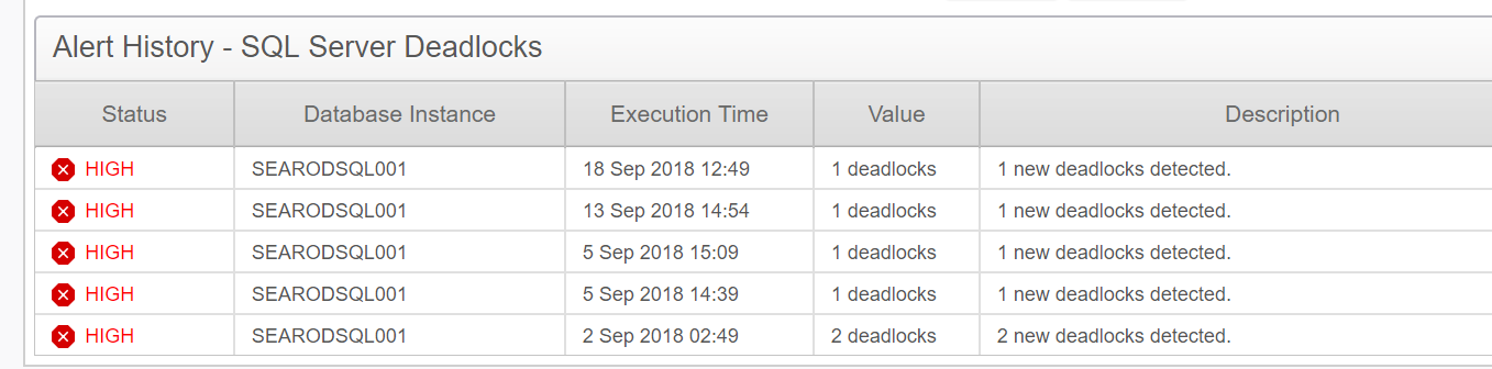

The link takes me to the alerts config page. If I look at this alert history, it does not show me any more details except the deadlock alert time. If I have to create a custom alert for every little thing, then why pay for this product.

The snapshot attached shows what I get when I click on the Details or History for deadlock alerts. That does not help much, other then knowing that a deadlock happened. I need to know what queries were involved in the deadlock, so I can trace them to the job that is running those and schedule those queries at different times. Can I create a custom alert that will give me that information? What tables in DPA Repository database have that information? Please send me a sample query.
