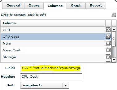

In the widgets you can also use xPath queries
Several useful links related to the xPath:Configure the alert criteria - SolarWinds Worldwide, LLC. Help and Support
Create Top-N widget showing drive path free space - SolarWinds Worldwide, LLC. Help and Support Full list of xPath functions and queries is here.
