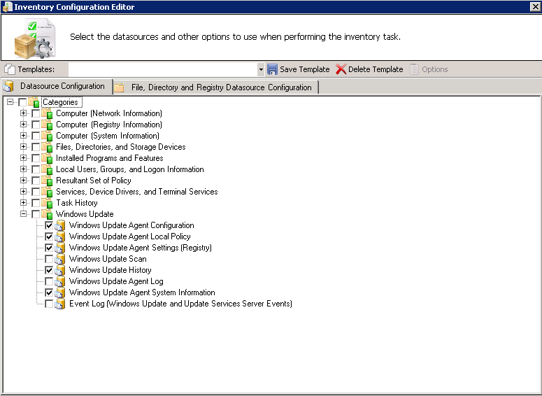

I'm having an issue getting the Event Log(Windows Update and update Services Server Events) and Windows Update Agent Log check boxes to stay selected. Every time I open the Inventory Configuration Editor these are reset to default.

When you open the Inventory Configuration Editor, it loads the "Default" template. You need to SAVE a user-defined template with those options selected, then LOAD that user-defined template when you load the Inventory Configuration Editor. (Note, you do not need the WindowsUpdate.log option for the reporting objective you've described.)
You might also consider this: Rather than adding these options to your regular inventory task, create an inventory task with ONLY the 'Event Log' option selected, and only run that inventory task when you need to refresh the Event Log data stored in the Patch Manager server.
