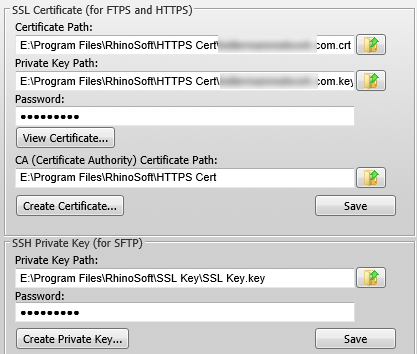

- Limits & Settings / SSL Certificate: Created SSL Certificate via wizard in Serv-U and saved to new folder in Rhinosoft folder. When done, chose to have it apply the newly created cert. Both paths and password are filled out as you can see below (made SSH one, too)

I don't know if it makes a difference, but on the server Serv-U is installed on, port 80 was already being used therefore I reassigned HTTP to port 81 via the listener. When browsing to 81 (http://servuserver:81), everything seemingly works as it is supposed to including the Java Voyager client.
