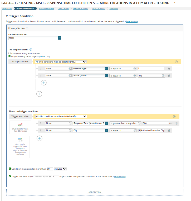

The above alert logic should be triggered if you have 5 or more devices with a 500ms response time for more than 30 minutes within a common city.
The alert does not seem to be working as desired.
The response time part of the alert should be good.
The condition of more than 30 mins or more should be good.
The Question is of the City piece. Is this causing the alert not to trigger?
We want the city to be the same on the device that trigger the alert but not have to configure an alert for each city.
Any suggestions or recommendations
