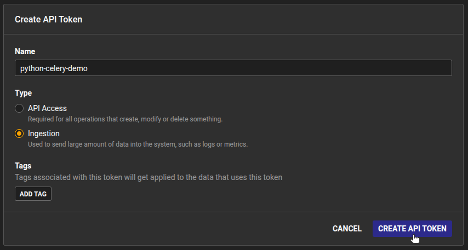

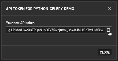

Navigate to Settings > API Tokens.
On the API Tokens page, click Create API Token.
Specify a name for your new API token. Select Ingestion as the token type. Click Create API Token.
Copy the resulting token value.

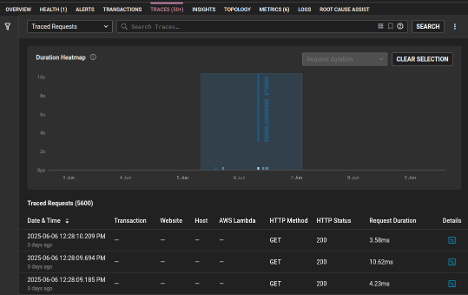

Clicking on the listed application will show the presence of captured traces, metrics, and logs, available in the sub-navigation of tabs at the top of the page.
</code></p><p><span style="background-color:#fff0cf;"><code><span style="font-weight:400;"></span>

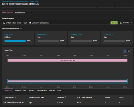

Click on the Traces tab. API request traces are shown across the various runs of the demo script.
Clicking on the details icon for any individual trace shows a breakdown of durations spent with each custom span.

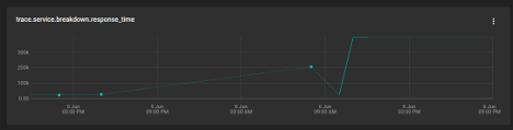

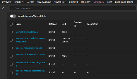

Return to the APM details page. Then, navigate to Metrics. Metrics captured alongside the auto-instrumented traces are displayed.
Individual metric visualizations are available, but you can also create custom dashboards that overlay metrics or play them side by side for analysis and correlation.

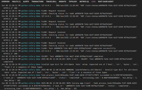

The Logs tab shows every log event emitted by the application and sent to SolarWinds Observability SaaS.
This is helpful for application debugging as well as monitoring resources and transactions.
