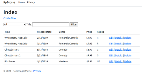

Now, when you open your browser to <span style="background-color:#fff0cf;">localhost:5000</span>
, you’ll see the application running:

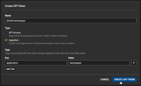

Navigate to Settings > API Tokens.
On the API Tokens page, click Create API Token.
Specify a name for your new API token. Select Ingestion as the token type. You can also add tags if you'd like. Click Create API Token.
Copy the resulting token value.

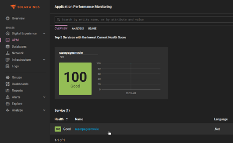

Confirm Data Ingestion With SolarWinds Observability SaaS
To confirm that your application is successfully sending telemetry data to SolarWinds Observability SaaS, log in to your account and navigate to APM.
There, you should see your application listed.

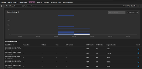

Clicking the application brings you to an APM overview page for your application. You’ll see the presence of traces (50+) and metrics (4) just by looking at the top bar nav.
The Traces subpage shows the custom spans that you have instrumented for tracing in your application's Movie model.

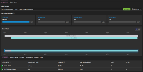

When you click on the details for any individual trace, you’ll see detailed information about the times spent in each of the components throughout the action.

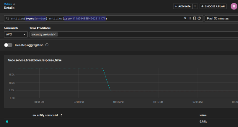

Similarly, you can visit the Metrics subpage for your application. From there, you can see metrics, such as the average response time.

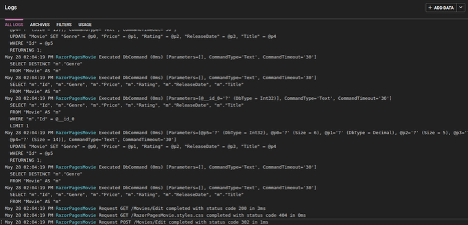

Finally, to see log events captured with OTel and exported to SolarWinds Observability SaaS, navigate to the Logs section of the site.
On that page, there’s a comprehensive set of log events, from your request middleware, explicit logging statements in your Movie actions, and within your database operations.
