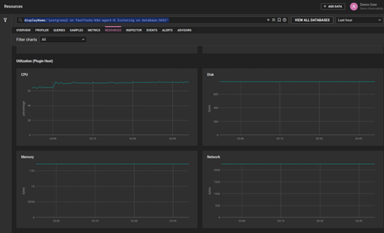

Viewing CPU and memory utilization
Keeping track of the CPU and memory utilization of your PostgreSQL instances is imperative. This is particularly important when using burstable cloud-based instances, which are becoming an increasingly common choice.
To view these metrics of your PostgreSQL instances in SolarWinds Observability, navigate to the left sidebar to select the Database feature.
From there, navigate to the Resources tab.
Overview of CPU/Memory utilization in the SolarWinds Observability dashboard

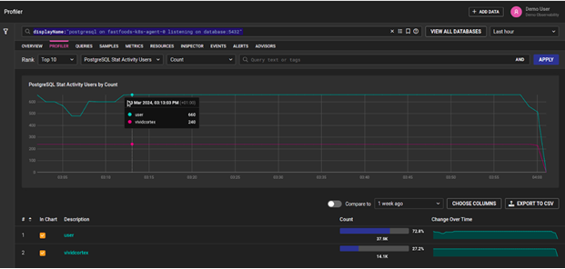

View connected users and services
To keep track of users and services connected to a PostgreSQL server, navigate to the Profiler tab and select PostgreSQL Stat Activity Users in the filtering drop-down menu:
Overview of active connections in the SolarWinds Observability dashboard

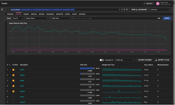

How to determine if your application is read-heavy or write-heavy
To determine whether the application using your database is read-heavy or write-heavy, inspect which queries are most utilized. In the dashboard, navigate to the Profiler tab and filter by Query Verbs.
Filtering by query verb in the SolarWinds Observability dashboard
In the above screenshot, most of the time (86.9%) is spent executing queries that are SELECT statements. This means the database is very read-heavy, and you may benefit from adding additional read replicas. This may also indicate that some of the queries require optimization, which we’ll cover in part two of this series. Modify the filter to show the total count of queries, affected rows, and other data points.

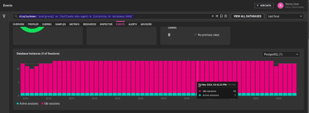

View the number of active sessions
To determine whether the maximum number of active sessions requires modification, monitor active session trends by navigating to the Events tab.
Overview of active sessions in the SolarWinds Observability dashboard

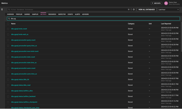

Viewing PostgreSQL autovacuum metrics
The Metrics tab contains additional helpful data points related to database activities, such as transactions, connections, and vacuuming.
Overview of PostgreSQL metrics in the SolarWinds Observability dashboard

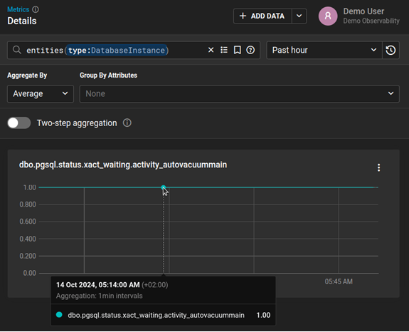

Clicking on a particular metric will display a time series graph showing how the metric value has changed over a specified time range. Metrics such as time_since_last_autovacuum
and autovacuum_waiting_activity
provide insights into whether the autovacuum process is fully optimized.
Autovacuum waiting activity metric in the SolarWinds Observability dashboard

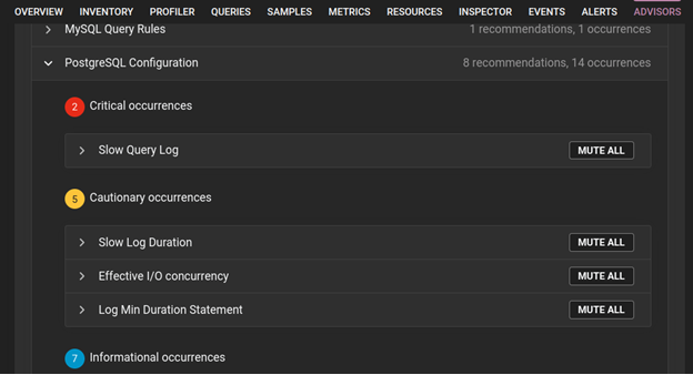

Using the SolarWinds Observability Advisor
SolarWinds Observability also provides an Advisor feature that offers useful suggestions on how to optimize your PostgreSQL instances. This feature can save ample time spent on identifying improvements which can be spent on more effective tasks. To access it, navigate to the Advisors tab.
SolarWinds Observability Advisor Feature - Summary
SolarWinds Observability Advisor Feature - Detailed by Advice Categories
