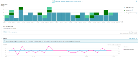

- Once drilled into a specific Query Performance Analysis (QPA) page, scroll down to the Table Tuning Advisors section. This section summarizes the advice aggregated to the table level and includes links to the advisor detail page.

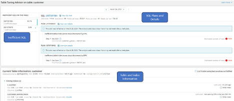

The Table Tuning Advisor page is densely packed with key intelligence related to the object selected. It has three main areas:
- Inefficient SQL—a list of queries accessing the table ranked by relative workload
- SQL and Plan Details—SQL and Plan details for the selected query
- Table and Index Information—current table information, existing indexes on the table, and the table's columns
Table Tuning Advisor example
Let's assume we are being proactive and want to tune something to have a significant impact. At a summary level, the tuning tab shows the tables with inefficient queries and ranks them based on inefficient workloads. The list includes an aggregated view of wait time for each table and the number of queries with inefficient plan steps on the table. These are prime opportunities for tuning.

Clicking on the "orders" table takes us to the Table Tuning Advisor page, which details inefficient queries accessing the table. This page pulls together what you need to know about the table regarding inefficient usage patterns, statistical information, the design of current indexes, and more.
Which steps in the plans are inefficient?
DPA uses a proprietary algorithm to find inefficient plan steps and causes of issues. Inefficient "producer" steps (Ex. full table/index scans) read data to be processed later by subsequent consumer plan steps. While consumer steps (Ex. sorts) can have a high cost, they are usually affected by a preceding producer step reading too much data. DPA can point out the inefficient producer plan steps as the focus of tuning efforts.
In the image above, DPA identified two plans used, as well as an inefficient step in each plan:
- SEQ SCAN—Step 7: A sequential scan of the "customer" table. Notice the predicate value shows a similar comparison which can be inefficient. The sequential scan caused an examination of 150K rows for a matching phone number.

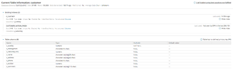

How many indexes exist on the table, and how are they designed?
Toward the bottom of the Table Tuning Advisor page, you’ll find the current indexes and their columns along with information about statistics and usage. Other table and index metadata is displayed after a real-time query to reflect the most up-to-date information. This is important for several reasons:
- Is the data churn for the table high? If so, insert/update/delete activity is high, and a new index could cause more harm than good.
- Could an existing index containing the column called out in the predicate help? Can the index be modified to benefit this query versus creating a new index?
- Were optimizer statistics generated recently? If not, and churn is high, updating the statistics for the table may be an excellent first step.
- Are indexes bloated? If so, and if scans are performing against them, check the health of the vacuuming process.
