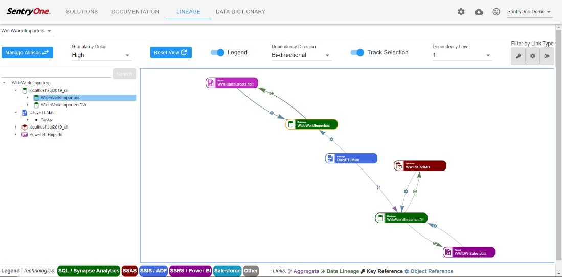

This can be a big undertaking in itself, as it’s all too common that documentation is incomplete (or non-existent) and knowledge of the whole system is fragmented. This is one of the challenges we’ve tried to help solve with SentryOne Document—in particular with its lineage functionality that can track dependencies across various technologies, as shown in the example below.
