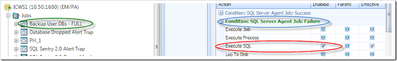

I’m going to assume that we’re already monitoring the server with SQL Sentry Event Manager, so from this point we want to choose a good candidate condition. One that is pretty common for a situation like this is “SQL Server: Agent Job Failure.” This condition is met when a SQL Server Agent job that is watched by SQL Sentry Event Manager logs a failure. We’ll enable the “Execute SQL” action for a backup job, as illustrated below.
Job, Condition, Action

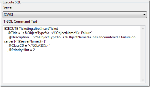

The interesting part comes when I define the T-SQL to run for my Execute SQL action. Below I will list the raw T-SQL as well as what it should look like in the actions configuration area of the SQL Sentry console. Then I will explain the special elements we see in the code and what they mean.
Entering the T-SQL command for the Execute SQL command is pretty easy. It’s done in the same area of the console application that was used to enable the “Execute SQL” action.
As seen below, you can select which server to execute the command on, and enter the command itself. Remember that only those servers that are monitored by SQL Sentry Event Manager will be listed in the “Server” drop-down.
I’m going to select my local server, since that’s really the only one I am monitoring right now, and enter the following for my “T-SQL Command Text”.
EXECUTE Ticketing.dbo.InsertTicket
@Title = '<%ObjectType%> <%ObjectName%> Failure'
,@Description = '<%ObjectType%> <%ObjectName%> has encountered a failure on server [<%ServerName%>]'
,@ClassCD = '<%CLASS%>'
,@PriorityHint = 2
At first glance, this is just a normal execute statement, but there are some interesting elements within the string literals that go along with event processing in SQL Sentry, and deserve some additional explanation.
First, any time you see the following format <%…%> in this context, it is telling SQL Sentry that we want to pass some part of the event data as a parameter instead of just keeping the literal text. Take for instance “<%ObjectName%>.” Before this command is executed, any instance of “<%ObjectName%>” will be replaced with the name of the object that caused the event. In this case it will be our backup job “Backup User DBs – FULL.” These parameters are all self-explanatory of what information they will inject into the command, except for one. The “<%CLASS%>” parameter is special. The “<%CLASS%>” parameter is what we call a “User Parameter”, and I will go into more detail about that in a bit.

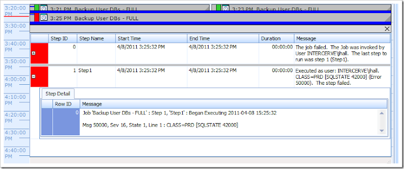

So, given this command, when my backup job fails, I should get a row in the Tickets table telling me that I need to investigate this tragic event. Now I’ll force the job to fail, and we can see it on the SQL Sentry event calendar, and I’ll also list the contents of the Tickets table.

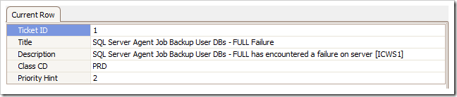

Above you can see the job failure and the detail for the steps in the job. This job simply threw an error with the message “CLASS=PRD.” That really doesn’t mean much, but it becomes important when we look at the user parameter in a bit. Now let’s see what we end up with in the Tickets table below:
My execute action parameters were replaced by meaningful information about the event. I know what job failed, and what server it failed on, and I can go investigate what happened using my SQL Sentry calendar view.
If this were a database for a real ticketing system, I’m sure several members of the technical staff would have seen it, and it would be classified and prioritized. Notice the “Class CD” which I mean to stand for “Class Code” and “Priority Hint” which I intend to be used to hint at the priority level.
Let’s assume that “PRD” stands for “Production” in a list of codes somewhere, and that “2” is hinting at a priority of 2. You can see how I could send in a custom parameter from my event output, or just a literal value, such as the priority hint.
The error I raised in the job step is where I got the ClassCD from. I could just as easily have done this with a code comment, print statement, or other mechanism since all I need for this to work is for the NAME=VALUE (in this case CLASS=PRD) set to be somewhere in the output of the event. I put it in the error message here because I knew I was going to make the job fail, and it was just quicker. It’s really just a T-SQL RAISERROR statement. I have it listed below:
RAISERROR ('CLASS=PRD', 16, 1);
