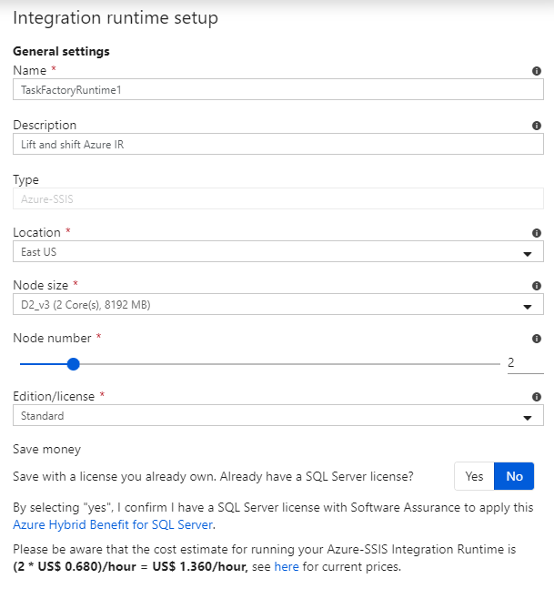

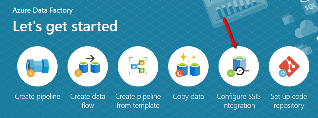

First, create your Azure-SSIS IR by clicking the Configure SSIS Integration icon on the ADF overview page.
On the 'Integration runtime setup' screen, configure the general settings of your Azure-SSIS IR.

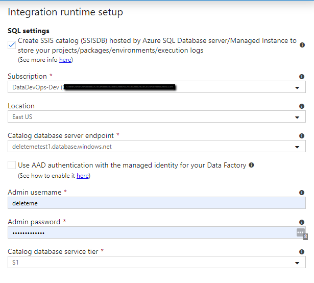

You will also select the subscription, location, and the Azure SQL Database server that will contain your SSIS catalog database. If you want the wizard to create the SSIS catalog, select the 'Create SSIS catalog' checkbox. If you already have an SSIS catalog on the SQL Server defined, clear this checkbox.

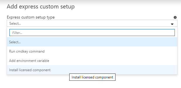

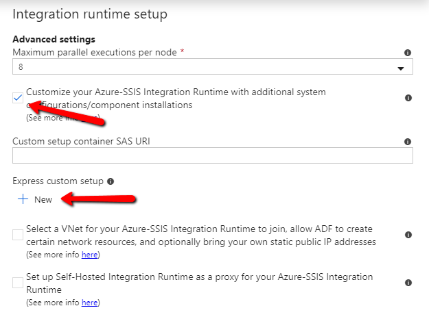

On the 'Advanced settings' screen, select the 'Customize your Azure-SSIS Integration Runtime with additional system configurations/components installations' checkbox. Then, click '+ New' below 'Express custom setup.'

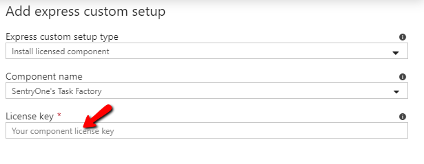

In the 'Add express custom setup' window, select 'Install licensed component' and then select 'SentryOne Task Factory.'
You can then enter your Task Factory ADF license key in the 'License key' field.
And that's it! Every time you start your Azure-SSIS IR, each node will have Task Factory automatically installed and activated without any further steps required from you.

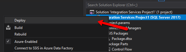

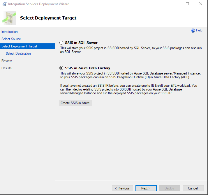

First, right-click your project and click ‘Deploy.’
Choose 'SSIS in Azure Data Factory' as your deployment target. (If you don't see the 'SSIS in Azure Data Factory' option, you'll need to upgrade Visual Studio 2017 and SSDT to the latest version.)

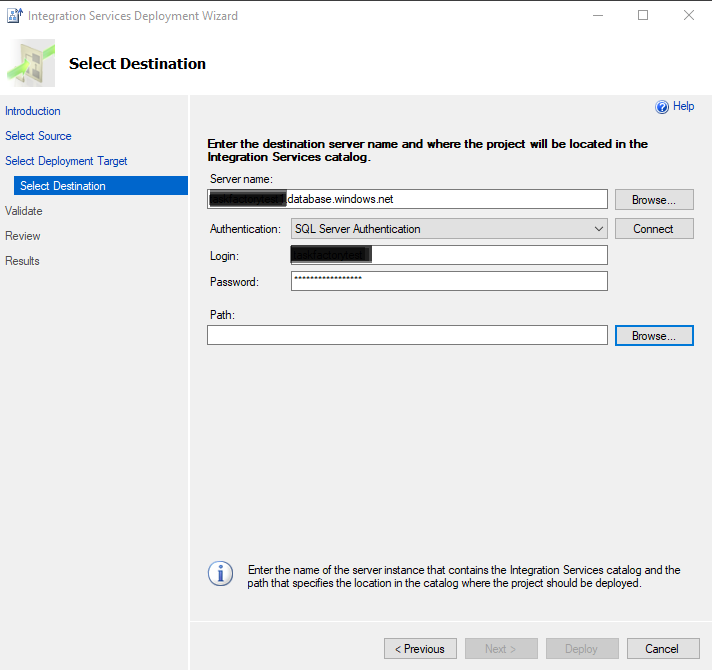

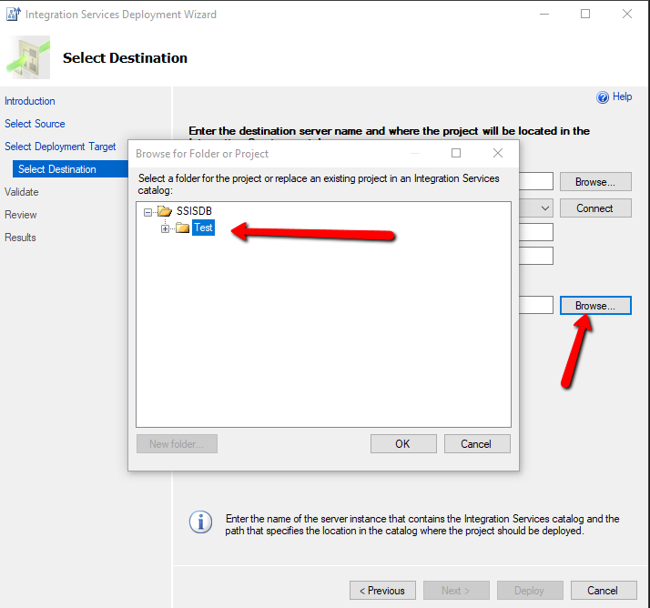

Enter the authentication information you entered in the 'Catalog database server endpoint' field when you configured your Azure-SSIS IR settings. Click 'Connect' after you enter the details to enable the Browse button for the path.
Click 'Browse' and choose which folder and project you want to deploy the packages.

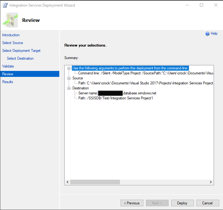

Review your settings to ensure they are correct, and then click 'Deploy.' Your packages are now deployed to your Azure-SSIS IR.

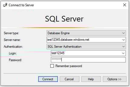

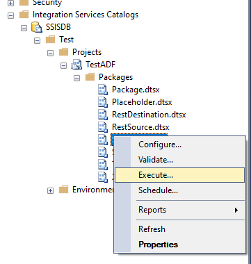

The first option is to use the same process as executing a package on a local SSIS catalog, which means connecting to the server you deployed your packages to from within SSMS and executing them.

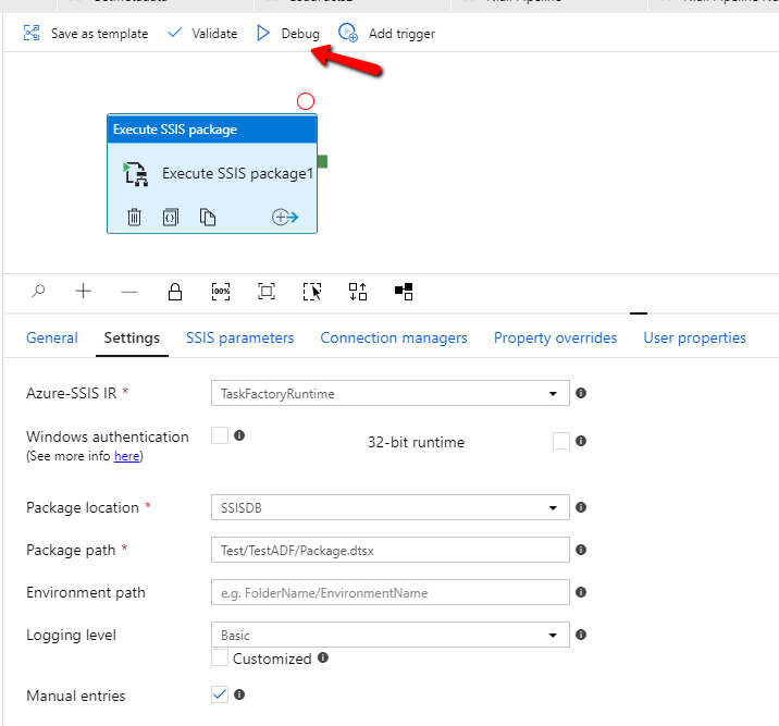

The second package execution option is to add an Execute SSIS Package activity to your Azure Data Factory pipeline and configure the package to execute. Then, click 'Debug' in the Pipeline design service to execute the package.
